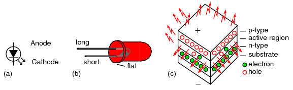

I've also touched up the drawing to show the internal cathode. Don't know if Dennis and you like it better or not, but here is the offering...
Original:
LED, Light Emitting Diode: (a) schematic symbol. (b) Flat side and short lead of device correspond to cathode. (c) Cross section of Led die.
Modified:
LED, Light Emitting Diode: (a) schematic symbol. (b) Flat side and short lead of device correspond to cathode, as well as the internal arrangement of the cathode. (c) Cross section of Led die.
Original:
Modified:
Subtle change is nice Bill, I will leave it to Dennis to approve the change.

Original:
Modified:
