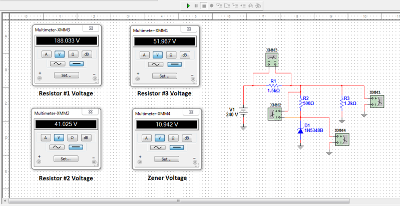

I also simulated the circuit, just to compare if the voltages are the same. I realized that they are not equal, but are close from the simulation’s voltage.

You don't indicated what voltage Vs is referring to, but your first few lines make it pretty clear that it is the node shared by R1, R2, and R3. If that's the case, then it is incorrect to say that the voltage at that node is going to be Vt-Vz. The voltage at the top of the Zener is going to be Vz (assuming it is reverse conducting, which it is in the first circuit). So if Vs is also Vz, then R2 has no voltage across it and, hence, no current through it.

The actual voltage on that node is somewhere between 50V and 55V.
