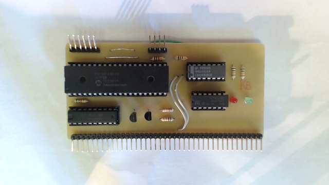

Hi all,
So I was supposed to stick to a design but during the programming of the computer an unfixable error occurred. Despite the fact that there where no floating inputs and all inputs either tied or used there was a problem with the keyport that meant it never worked correctly and caused frequent system errors. I spent a number of solid days trying to fix it but getting no where so I decided to throw in the towel and brought in the big guns, a PIC18F45K22 based IO card.
While designing the new IO card I realised that a useful computer will be more rewarding than a simple blinking lights machine so this computer now has the following (and is working)
  • BIOS with system calls (RST instructions)
  • PS/2 Keyboard
  • UART
  • I2C Memory
  • Composite Video Output
  • ROM Chip now sits in a ZIF socket
  • Boots over I2C
What needs doing now? Well, I intend to write an inbuilt assembler, design a BASIC system, get a FAT going and far future...wifi.
