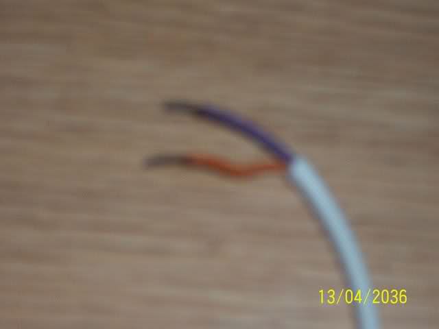

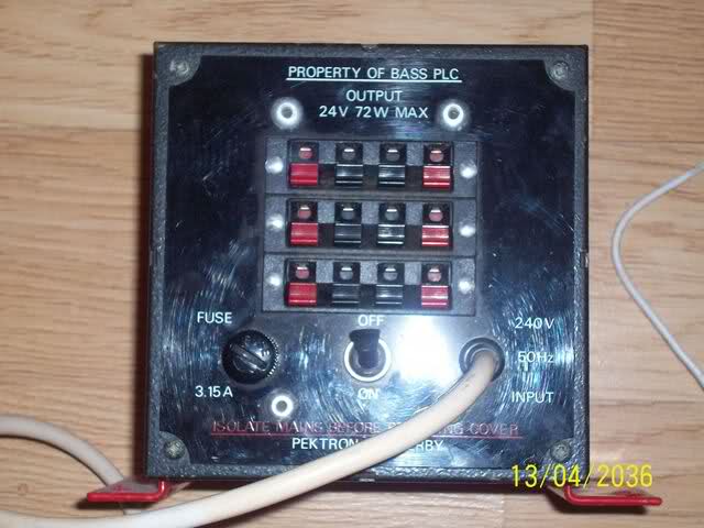

Problem ive got is the box has red and black connectors (as below)
and the wires are Orange and Purple (as below)
Does anyone know the correct wiring requried here in order to get the taps to light up?
Ive tried both ways but nothing seems to work?
Have I maybe blown a fuse with attempting the wrong way?

Are the purple and orange wire from the 240V connection?
Is the fuse (3.15 A) ok ?
Is the switch in working order?

The purple and orange wires are from the bar taps and will be used for making the taps light up.
Switch is in working order.
Fuse appears to be ok but couldnt be certain?
Any idea what the correct wiring should be?
Thanks a lot

The fuse can be measured with a multimeter in resistance measurement.
When you do measure a value of about 0 ohm, the fuse is ok.
To what is the purple and orange wires connected?
Can you follow the wires to where they are connected?

If the output is 24 VAC, then there is no polarity to the wires. AC doesn't care. The label does not state the nature of the 24 volt output.
PackratKing
Joined Jul 13, 2008
847
Black / Red quick connects on the face would say DC to me......... 240v 50Hz input would be foreign to the USA anyway.
What is on the reverse of the box ?
