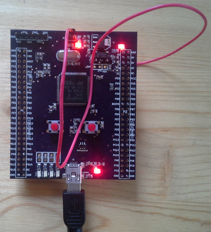

    I have just finished soldering an stm32f4 board someone else has designed for me. Tiny problem is that I cannot get this board alive.
    3.3V gets to the chip. There is a BOOT<>VDD jumper and a reset button same as on discovery boards, but my windows does not recognize the device as "STM Device in DFU Mode". And another thing - my multimeter does not show any life on the 8MHz oscillator.
    [​IMG]
    Full-size picture: http://rusefi.com/images/forum_posts/brain_board_full_size.jpg
    Schematics: https://svn.code.sf.net/p/rusefi/code/trunk/hardware/brain_board/Schematic.pdf
    KiCad sources: https://svn.code.sf.net/p/rusefi/code/trunk/hardware/brain_board/
    Should I be expecting the oscillator to tick on a brand new board without firmware? Should I be expecting the chip to contain the bootloader recognizable as "STM Device in DFU Mode"?

    AFAIK DFU Mode in this context is a way to program STM32F4 chip using the USB OTG interface. On STM32F0DISCOVERYif you jump the BOOT pin and connect to your STM32F0DISCOVERY via the microUSB cable (not the miniUSB ST-LINK), you are connecting directly to the chip and it's firmware. I am trying to repeat that - first step would be Windows recognizing a USB device which is not happening so far.
    I've just learned how easy SWD/ST-Link way is and the board is now alive! Apparently the problem is just in the USB department, but that should be easier.
  4. russian
    Thread Starter Member
    Sep 1, 2012
    55
    1

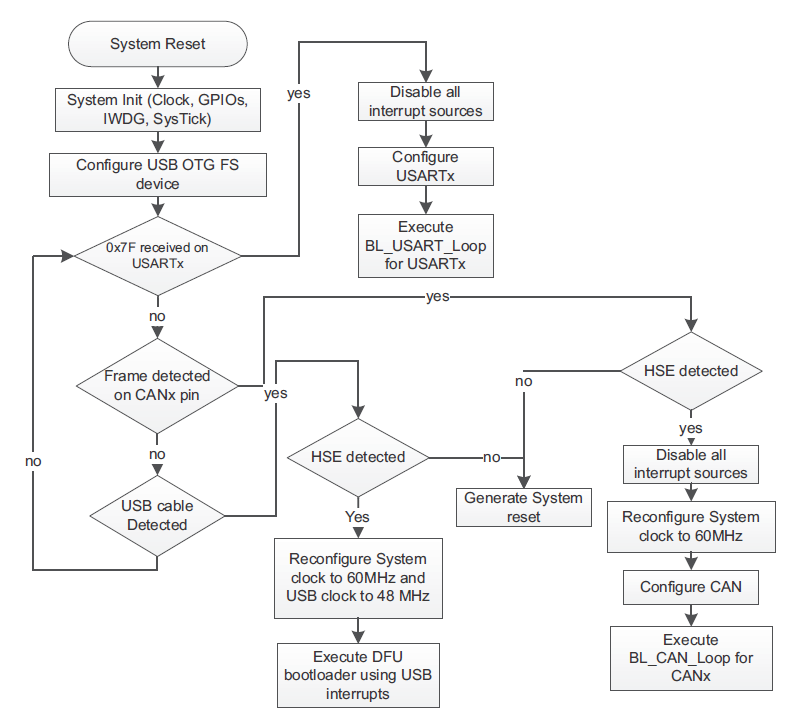

    So one issue was that PA9 was not connected to USB VBUS pin, once I did that I got USB working from my firmware. But I still cannot figure out how to program the chip via USB.
    I was pointed at "AN2606: STM32 microcontroller system memory boot mode"
    [​IMG]
    [​IMG]
    boot1 is PB2
    [​IMG]
    I guess I am still missing something.
