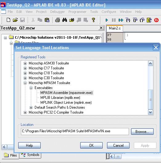

    I'm running MPLAB v8.83 under XP without any issues.
    Here's something to try: Open your project in MPLAB and look at your tool locations.
    On the menu hit Project | Set Language Tool Locations... and expand the Microchip MPLAB Toolsuite and then the Executable area. Use the Browse... button for each of the assembler, librarian, and linker program to insure you are truly pointing at the proper programs.

    Yes that seems to be ok. I have MPLAB running on other computers too.
