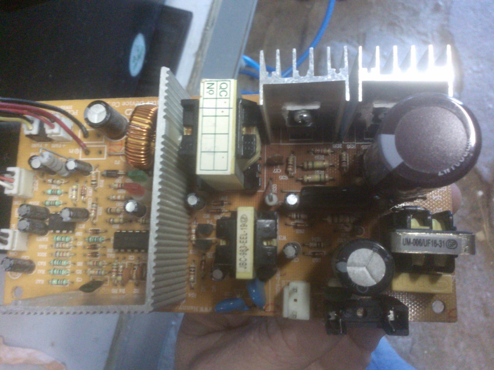

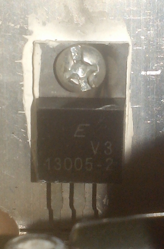

Does anybody could help me to recognize this transistor ?
If it is a transistor, it could be a voltage regulator ...
Thank's a lot.

What you have there is a Switchmode psu, chances are there are two of them on the heatsinks next to the large electrolytic capacitor. in a pushpull mode,
If its on the other large heatsink, its a Dual Shockley diode.

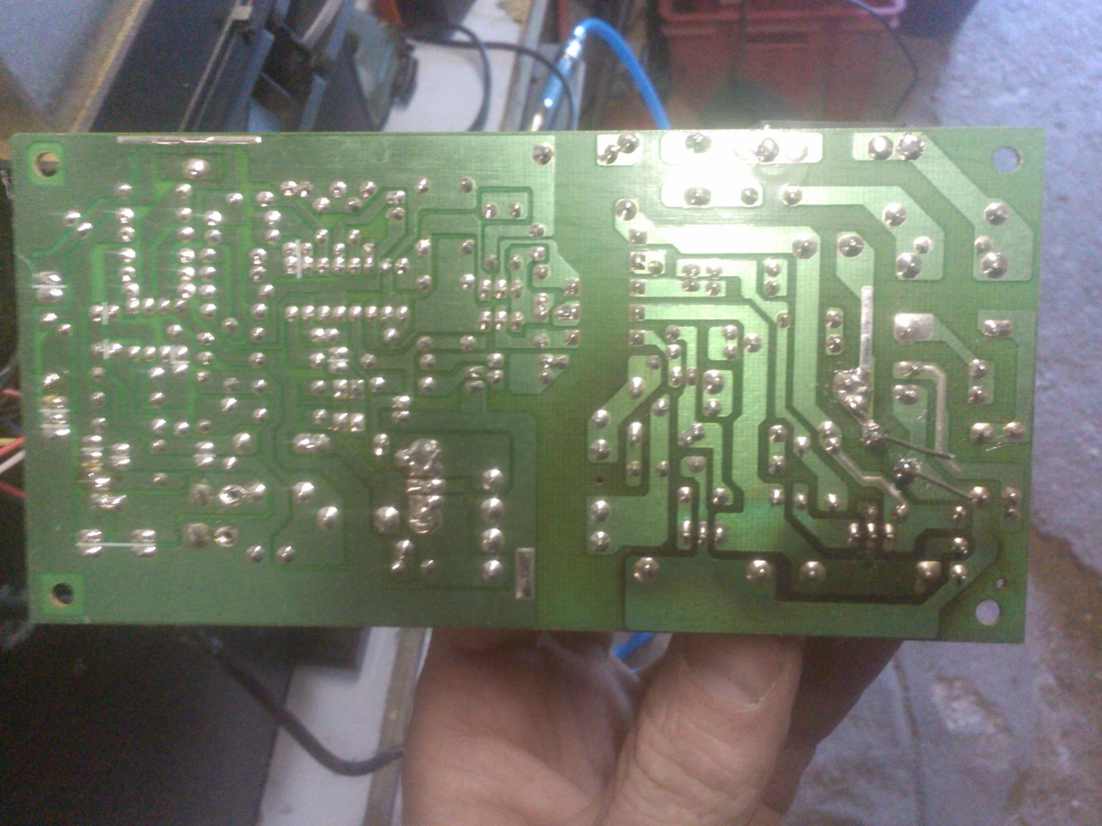

It is the single transistor, right of the main power transformer, left of the bulk holdup cap. Based on the bottom side photo, I think the right-most heatsink also has a single TO-220 device.

Make sure it's not this transistor PHD13005 "D" for diode
this is the one that was in my cooler it has a built in C E reverse diode in it.
the dash "- 2" on yours mite mean no diode or (has diode) not sure .
If one of them is still good you can check for the diode with a meter

It could be the MJE13005 transistor:

I'd put it a bit stronger than "could be". Its a pretty common device for that sort of application.
For substitution - if there's 2 of them; its a push pull switcher, for a PSU running from 220V, a 500V transistor will probably do, if there's only 1; its a flyback converter and the transistor needs to be rated *AT LEAST* 600V.
