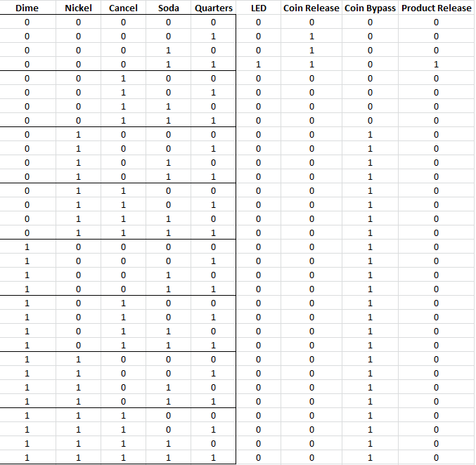

    So I have this assignment, and I'm not sure if I'm headed to the right direction. The assignment is,
    "Consider a vending machine where all items cost 50 cents. The vending machine accepts only quarters. Any insertion that is not a quarter will simply drop through (by mechanical action) to the change bin and will not affect the counter or the control circuit (so the control circuit is unaware of it). Each time a valid coin is inserted, the machine must keep track of the total value of all the coins inserted for this transaction. When it has counted 50 cents, it lights a display instructing the user to make a selection. If the user attempts to insert additional coins at this point, the new coins drop through to the change bin without being counted, the display remains lit, and the machine continues to wait for a selection. There is no need for a change return. There is a “cancel” button for the user to abort the transaction. Pressing “cancel” releases all the coins captured for this transaction to the change bin, resets the count to zero, and turns off the display light. The machine is ready for the next transaction. When the user presses the selection button, the product is dispensed, and the machine is reset to its initial state awaiting a transaction. For the purpose of this problem, assume that there is only one product choice.
    Note that the outputs are: (1) the display light, (2) the coin release (which empties the coin holding bin to the change chute), (3) the coin bypass (which routes coin inserts directly to the change chute), and (4) the product release. What are the user inputs?"
    So far, I have this table. I'm amssuming that pennies don't exisit, and only one type of currency exists. I was thinking that there should be Don't Cares, but I'm not sure.

  2. WBahn
    Moderator
    Mar 31, 2012
    18,079
    4,917
    Read the instructions more closely. What does it indicate as far as anything other than quarters are concerned?
    What is your "button" input?
    Go through your table and ask yourself if it makes any sense at all.

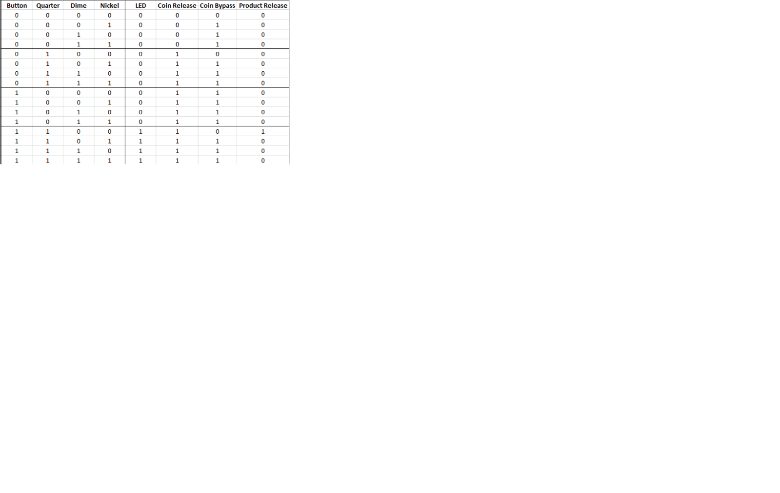

  3. smokingpotnonstop
    Thread Starter New Member
    May 8, 2014
    21
    0
    The button is there that the user presses to get the soda. It said if it's not quarters it will get dropped. So I figured having the coin bypass on 1 will set it off. My teacher also said we can list assumptions. So I state that I assumed that pennies don't exisit and that there is only one type of currency. As far as light displaying, I just assumed it was a LED and it turned on when 50 cents was in. I just noticed that I forgot the cancel button. However, it doesn't make any sense when I tried to input it on the table. I revised the table, and I'm still not sure.

  4. djsfantasi
    AAC Fanatic!
    Apr 11, 2010
    2,899
    870
    What is the second sentence of your quoted problem statement? What does it say about nickels and dimes?

  5. WBahn
    Moderator
    Mar 31, 2012
    18,079
    4,917
    If you are going to just assume that the LED is going to somehow light up when 50 cents has been put in, why not just assume that everything is going to somehow work like it's supposed to and be done?
