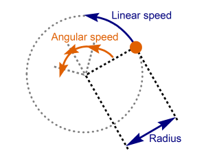

Intuitive interpretation
Suppose the vector field describes the velocity field of a fluid flow (such as a large tank of liquid or gas) and a small ball is located within the fluid or gas (the centre of the ball being fixed at a certain point). If the ball has a rough surface, the fluid flowing past it will make it rotate. The rotation axis (oriented according to the right hand rule) points in the direction of the curl of the field at the centre of the ball, and the angular speed of the rotation is half the magnitude of the curl at this point.
As the article says:
In vector calculus, the curl is a vector operator that describes the infinitesimal rotation of a 3-dimensional vector field. At every point in the field, the curl of that field is represented by a vector. The attributes of this vector (length and direction) characterize the rotation at that point.
The curl gives us a direction of rotation and length/magnitude of that vector of rotation. What does the line in red mean in the quoted text above? Please help me with it. Thank you.

Imagine a ball is suspended in the are in front of you. The motion you would see would be very different if the axis of rotation were vertical, versus horizontal left-to-right, versus horizontal going straight away from you. That's the 'direction' part. The magnitude is the (angular) speed, namely how fast the ball is spinning.

Thanks a lot for letting me know about that book. I understand that direction part of the curl but I don't get it where the Wikipedia article says that the curl's magnitude is half of the angular speed? Why is the magnitude half of the angular speed? So, please help me if possible. Thank you.
