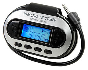

    I just bought this transmitter- http://electronics-diy.com/product_details.php?pid=302&name=Wireless%20PLL%20Stereo%20FM%20TX%20with%20LCD%20%28fully%20assembled%29 which is nice because the price. it does digital tuning, it has memory banks for set freq, and its PLL stabilized.
    [​IMG]
    also, the output is claimed to be 50mw, which in my case will usually be fine, but i also want the option to turn on an amp to make the output to 500mw or more.
