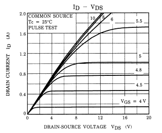

This is a very basic question. As I understand it, in a MOSFET the conductivity from source to drain depends on the voltage from gate to source.
I have a a K2718 , the datasheet tells me this:
So I set up the transistor like this:
With a voltmeter I checked Vgs = 3.8V. From the graph I expect the drain current to be around 150mA. However if I try to short R2 with an ammeter I am effectively shorting my power supply (which starts making funny noises). Why?

No, the current through R1 is (5V-3.8V)/1k=1.2mA, assuming the voltage across the diodes is 3.8V. Are your diodes LEDs?
The curves in the datasheet are typical. The drain current may be a lot higher than 150mA @ Vgs=3.8V.
If you want to measure drain current, connect R2 from drain to +5V, connect the source to ground, and then short out R2 with your ammeter. There is a subtle difference when you do it this way vs the way you drew it. Ammeters have resistance. The voltage drop across that resistance will reduce Vgs slightly, so Ids will be less than if you do it the way I said.
You can burn out your MOSFET if your power supply can deliver the current drawn by the transistor. For example, if Ids is 500mA, your FET will be dissipating 2.5W. It will quickly get too hot, and be damaged.
EDIT: High drain currents are typically measured using short pulses. See the schematic on p.2 of the datasheet.

As expected I was making a trivial mistake: confusing source and drain. I don't care if the whole world thinks they are appropriately named, they are not.
My original goal was to provide a current limiter (at about 1A) for a motor driver circuit. It seems to work now - is there a reason I shouldn't do it this way? All current limiter examples I have found use more than one transistor.

also swapping drain and source is quite serious mistake. datasheet shows clearly pinout and names of all terminals (check package info on the very first page):
http://www.datasheetcatalog.org/datasheet/toshiba/3014.pdf
Datasheet also shows that there is internal diode across drain and source (quite common in power transistors). So when you had D and S swapped and R2 shorted by ampmeter, you had only that diode across 5V supply (load would be handy). This diode was clamping power supply output to about 0.8V and the noise you heard was power supply complaining that something is not right.
the diodes D1 and D2 are shown as rectifier diodes so I would expect Vg=1.4V (gate voltage relative to ground). Higher gate voltage is possible with different diodes (LEDs for example) but this is not indicated (Ron already asked this but you still didn't answer).
Note, actual Vgs is going to be smaller than Vg due voltage drop across R2 (which is negative feedback in this case). I wonder how did you measure Vgs=3.8V!? If you are certina this was Vgs then something else must be going on (hopefully this was measurement of voltage across R1).

I think it was because he had mentally swapped the surce and drain. He has 1.2V across the diodes, but actually measured from gate to drain, which would be 3.8V.
