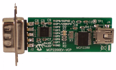

I'm using an atmega328.Which microcontroller? Does it have a UART built in? Most applications like this use a uC with a UART on board. The UART signals interface to a PC's RS232 port using something like a MAX232 to do the level shifting.
You could also use a microcontroller with built in USB capability or use something like an FTDI USB-UART interface chip to interface the uC's UART with USB.

It does have uart but I have to program it etc and its proving difficult. I was looking for a chip that does something along the lines of input my data into one pin and connect a uart to usb cabel on another pin and the data should flow to the USB pprt
UART (most likely through UART-to-USB converter) is about as easy as it gets. Anything else will be much harder.It does have uart but I have to program it etc and its proving difficult.
