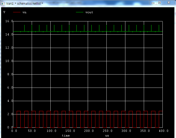

The condition of Op-amp is like that
OP Amp : Rin > 100K, Av > 10000, Ro < 100
So, I made it through Two stage CMOS op-amp
* Schematics Netlist *
C_C1 Vout _N_7 1uF
I_I1 _N_9 Vss DC 90uA
M_M1 _N_8 Vn _N_6 _N_6 PMOS0P5 L=1U W=18U
M_M2 _N_7 0 _N_6 _N_6 PMOS0P5 L=1U W=18U
M_M3 _N_8 _N_8 Vss Vss NMOS0P5 L=1.0U W=5U
M_M4 _N_7 _N_8 Vss Vss NMOS0P5 L=1.0U W=5U
M_M5 _N_6 _N_9 Vdd Vdd PMOS0P5 L=1U W=18U
M_M6 Vout _N_7 Vss Vss NMOS0P5 L=1.0U W=5U
M_M7 Vout _N_9 Vdd Vdd PMOS0P5 L=1U W=18U
M_M8 _N_9 _N_9 Vdd Vdd PMOS0P5 L=1U W=18U
V_V? Vss 0 DC 15V
V_Vsig Vn 0 pulse (0V 2.5v 10uSec 0.1nSec 0.1nSec 10uSec 20uSec)

So, Why didn't it operate ?
