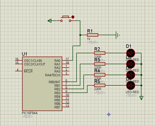

Hello everyone here .
The program is like this :
Using a microcontroller (pic16f84a) , 4 leds on port b , and one button on port a .
when i press the 1st time , the led1 lights up , when i push 2nd time , led2 lights up and the first shuts down , and so on for the 4th one , after that when i press the button everything is off , and the cycle starts again .
This is my vision of the program , but unfortunately it didn't work out :
Please share your ideas .

MikroC do have a software debugger? In cases like this, the software debugger is one of your best friends. And you should learn how to use it, like do single-stepping, setting breakpoints, adding watches, and stimulus. Will work much faster than this forum also. But of course this forum will always be open for your question if you struggle

From the overabundance of fault data provided it is an inescapable conclusion that the code is broken.
You may also want to look up the concept of switch debouncing, as this program is a prime example of where one is required.

The concept of switch debouncing, is not required in the perfect world of the Proteus simulator, which i guess you have been used to test your program. However in the real world. It is a very important factor. Causing a lot of problems then not handled correct

The MikroC inbuilt libraries have a button() function which performs some debouncing, it is fine for such a simple button sequence task.

As long as you use the ISIS Proteus simulator to test run your code. Switch debouncing is not something you have to worry about. Your problem is in the code. Therfor use your time on learning how to use the MikroC debugger instead.

I have looked at the code, while the idea is there, the issue here is wishful thinking.
The PIC does not have any idea how much delay you want. So at best the LEDs would light up very very fast.
Also, you don't test for the button to become released at all.
This is the process to learn programming- to transform a human language into a programming language and in the end, machine language.
C language often has many different ways to solve it, and assembler allows a lot of creativity, but they are unforgiving.
They are binary languages, if there is a tiny bit wrong, everything can fail and the chip does not bother.
While humans, if you talk to someone and it is expressed a little bit wrongly, you are still able to understand.
It is helpful to use the single step debugger and really observe what each line is doing. Later you can write more complex expression or even more than one into each line.

You have some code written. And it compiles. That is good. But still the program might not work as you want it. And that is then the debugger comes in. Why are you so reluctant using it ;) As suggested try to detect the releasing of the button. Just add a simple while statement in in state. Something like this
Rich (BB code):
if((start==1)&&(x1==1)){
x1=0;
x2=1;
led1=1;
led2=0;
while(start==1); /*Do nothing until button released*/
Also then working with micros. The basic data type for variables like x1 is signed or unsigned char. As the char data type only take one byte. Int is a two byte variable. Not that using the int type is causing your problems
