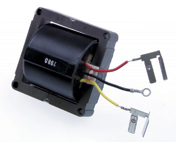

    Have you considered one of the little GM ignition coils? I don't know how much space you have available in your box, but the coils they started using in the late 80's or early 90's are much smaller than the old cylindrical types.
    There's also the type that went into the distributor caps of the late 70's and early 80's GM V8 engine cars. They look like this:
    [​IMG]
    The HV tap is machined into the middle of the other side of the transformer. You'd have to figure out a way to attach a HV wire to it.
