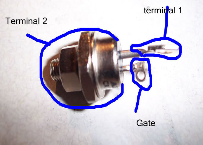

ive bought 6 stud scrs but when I came round to testing them they did not work, I cannot find the datasheet anywhere but I guessed the pinouts: small connector-gate case-cathode big connector-anode. I am begining to wonder if dropping them damaged it?... I hope not.

The usual way to test SCR's is to use a meter and confirm that there is no conduction anode-to-cathode, or cathode-to-anode. Using the diode check, look for open going gate-to-anode. The gate-to-cathode may look like a short - there may be very little difference in conduction when you reverse the leads. And the conduction may have very little resistance - not at all like a pn junction in a transistor.
If they look ok on a meter, then you will need to check your trigger circuit. If you can post up the circuit, maybe we can see something not quite right.

Ok I have tested between terminal 1 and 2 and there is no connecton +/-. There is a resistance of 32milliohms between gate and terminal 1 only +/- polarity
Refer to the picture below.

The 32 mohms does sound awful. Try one other check. Put your meter across the SCR reading ohms, and connect the positive lead to the gate - just touch it briefly. If you have the polarity correct, the resistance anode-to-cathode should go to zero - the device is on and stays on because the voltage across it is DC.

I did what you said, if I join gate to terminal 2 it reads 32milliohms regardless of the polarity. But if I join gate to terminal 1 it reads nothing with the polarity around either way... doesn't sound so good.
Would dropping it affect it, are they fragile?

The Stud on this type of thyristor usually is the Anode, the small terminal is the Gate and the one next to it is the Cathode. Use a bench power supply or a car battery and connect the positive thereof to the stud. Now connect one terminal of a 12V automotive lamp to the Cathode and return the other terminal to the Negative terminal of the battery or power supply. Take a 10 ohm or so resistor and connect one side also to the positive and momentarilly touch the gate with the free end of the resistor. If all is well, the lamp should light up and stay on until the circuit is broken again.
Usually when it comes to this size thyristor, your multimeter does not have enough current to trigger the device into conduction, so a simple circuit as described above is quite a useful way of testing SCRs and TRIACS.:)

Well I did that and it turned on for about 2 seconds then cut out, for a expirment I removed the cathode and found out it was doing the same thing... all of the currant was passing through the gate!!

Ahhhhh!! I broke one of my scrs, how I dont know, but I tried another one it worked! the weird thing is when I touch the gate to v+ it turns on then if I touch it to v+ again it will turn off, is this normal??

The thyristor should turn on and latch when the gate is made positive with respect to the cathode and although it turned off when you touched the gate with a negative polarity, it is not the correct way to do this. Thyristor turn-off should be done by interrupting the current from anode-to-cathode. One method is to put a switch in line with the main current path and another way is to temporarilly short out between anode and cathode. This is also accomplished by means of commutating capacitors (which effectively do what is explained above).
However, there are devices known as GTOs (Gate-Turn-Offs). They are designed to turn off with a negative pulse on the gate (or a special second gate provided for this purpose), but they are not freely available through the normal component suppliers and were used in limited numbers in the past.
Another important factor to remember is that a thyristor has a minimum holding current in order for it to stay on after gate triggering, also it must have a certain minimum and maximum gate current. Unfortunately, this can only be found on the data sheet for a particular thyristor. :rolleyes:
