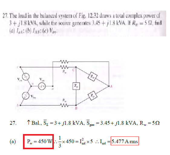

Hello guys, Electrical engineering student here :),
I was wondering if someone could EXPLAIN me why they did this in this problem:
Serously i have been trying to figure out, but it seems that they just gave a random value to Pw, or am i wrong?
Thanks

:eek: thank you so much. Sometimes it takes me more time to analyze easy things than harder ones. You just gave me what i needed to understand all the excersive, serously :)
