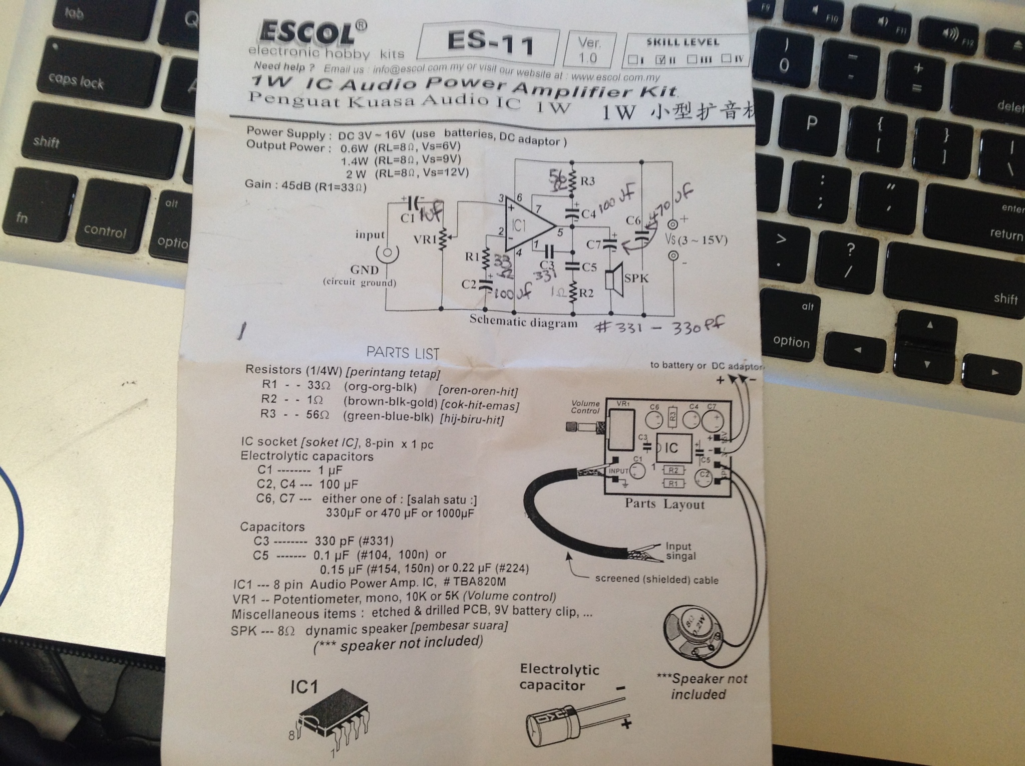

Bought a couple of these little amp kits. I soldered one and it works good with a electret microphone. I 'm now trying to breadboard the second kit to make it more suitable for piezo disc pickup. My plan is to get the stock kit amp up and running on a breadboard, then experiment with various buffer circuits. Sounded easy, but for the life of me I can't get it up and running. Obviously fundamentally wrong with my interpretation of the schematic???
included a couple of pics..hopefully someone more experienced can spot what I am doing wrong. Disconnected the battery terminals to take pic (in case anyone spots that ??? I'm stumped.
heres the data sheet http://www.st.com/web/en/resource/technical/document/datasheet/CD00000118.pdf. kit looks pretty close to figure 2.
I swapped out the chip to rule that out, also done a continuity test on breadboard..it seems OK. Anyone got a suggestion.If someone could explain how I could test the amp with my dmm, and do continuity through the circuit. that would be appreciated too. For now I'll treat it as a good learning exercise.
