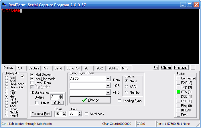

    Another question ...
    I'm using a terminal progrm on a desktop PC (TeraTerm) to debug my code. Its a pain because, for example, when I send an integer representing temperature the terminal program will interpret this as an ASCII character and display the ASCII equivalent. To get a readable display on TeraTerm I have to parse out each individual digit in my number, find the ASCII equivalent for that digit, then send this to TeraTerm. I have it working fine. But now I want to work out the detailed serial communication protocol between my temperature controller board and the main system board. I would like to work on this initially without the main board, using a desktop PC and a terminal program. But I would like to find something that will display RX values as integers, either in hex or decimal. And I would like to be able to TX integers the same way. Does anyone know a terminal program that will do this? I do not have any tools loaded to write my own desktop application, and I'm not really interested at this point in doing so. I'd rather find a terminal program that has this feature, if one exists. Thanks again for all the help.

    The character disaply you suggest has exactly the same behavior as the terminal program I'm using. Integers sent to the character display are decoded and the ASCII equivalent is displayed. I want to directly display the integer that I send. Because in my real application another micro-controller will be getting this data and interpreting it as integers. I want to simulate that behavior.
    If I can't find a terminal program that displays in decimal of hex, I will be forced to have to swite something to do this.

  15. MMcLaren
    Well-Known Member
    Feb 14, 2010
    759
    116
    Is RealTerm one of those that supports hex display?

  18. JMac3108
    Thread Starter Active Member
    Aug 16, 2010
    349
    66
    Thanks MMc!!!
    RealTerm is doing exactly what I needed. Now I can just sent integers directly over the comm port to debug my program and RealTerm shows them directly. I can eliminate all the code I wrote to turn integers into ASCII equivalents that was necessary when I was using HyperTerm or TeraTerm.
