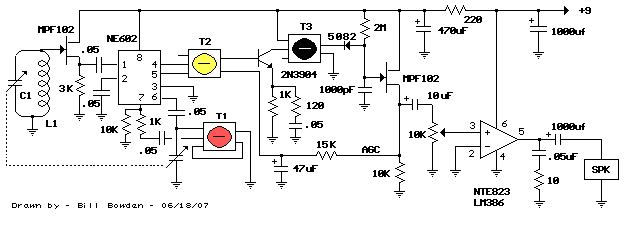

  7. shano80
    Thread Starter New Member
    Sep 13, 2010
    9
    0
    Hello, Im trying to build a L.O. with a 42IF300 transformer from mouser with a SA602 double balanced mixer and oscillator IC. Basically Im working on a superheterodyne AM reciever.I was expecting to be able to put an o-scope on pin 6 and get a frequency that is 455khz higher than the RF.Highest frequency I get with my L.O. configuration is 1500KHz using a 141/60pF capacitor.
    [​IMG]
  8. bertus
    Administrator
    Apr 5, 2008
    15,796
    2,383
    Hello,
    Pin 6 is the input for the oscillator.
    Pin 7 is the output for the oascillator.
    The oscillator signal is very weak and can only be measured using a buffer.
    See figure 6 in the attached datasheet for more info.
    Bertus
