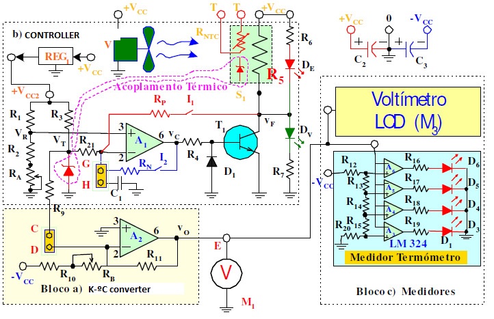

    Hello!
    Can someone please help me understand how to analyse this circuit? I just can't seem to get it...
    [​IMG]
    I need to find the resistor RA value when I want to impose a 45ºC temperature on resistor R5.
    Also, how can I find the current that heats the resistor R5 when both switches are open or when just one of them is open.
    I just need some advice to see if I can understand this and do it. Thank you so much!

    Sorry, I totally forgot.
    Vcc=12V;
    R1=330K;
    R2=110K;
    R3=10K//8,2K;
    R4=R6=R7=1K;
    R5=47ohm/5W;
    R9=R11=10k;
    R10=33K;
    R12=R21=100K;
    R13=R14=R15=910 ohm;
    R20=2,7K;
    Ra=Rb=22K;
    Rp=Rn=10M;
    Rntc=10 k (at 25ºC)
    C1=22microF/25V;
    C2=C3=100microF/25V
    Variation of the resistance with T: R(T)=R(T0)exp[B(1/T)-(1/T0)]
    T0 is usually 298,15K
    B is not given, it just says that it's a constant and it depends on the material properties.
    And that's all I got.
    Thank you!

    Assuming the transistor is fully saturated then the current through R5 is 12V/ 47r = 0.255 Amps.
    so what is the voltage out of the regulator Vcc2?

    The questions says: Determine the resistor RA value (potentiometer as rheostat) so that the controller imposes a 45ºC temperature on resistor R5. Potentiometer is linear, so resistance is proporcional to rotation angle. Admiting that potentiometer maximum rotation is 270º, how much should you rotate the potentiometer? Considere Vcc2=Vcc=12V

    Is the amplifier is driven with +12 and -12 V ?
    What is the value of the zener diode ? (it's red) I am guessing that it is used to measure the temperature. For one of the diodes I looked up (1N5264B), it has a 0.097 %/k temperature deviation. So for a change from 20 ºC to 45 ºC, the zener voltage changes by 24.2 mV.
    The loops with Rp and Rn (C1) provides some hysteresis to the op-amp. It will not effect the temperature or the setting of RA. Also, the red LED will be on when heating and the green LED will be on when the the temperature is above the set point.
    The voltage between R1 and R2 varies from Vcc2 * (110K / (110K + 330K)) to Vcc2 * ((110K + 22K)/ (110K + 22K + 330K)) or 3.0000 V to 3.4286 V.
    Without knowing B, we would need to know the temperature range of the controller.

    The diode is the 1N4001, I can't find it's temperature deviation. The LM355 temperature sensor's temperature range is -50ºC to +150ºC. The only information about B is that it depends on the properties of the material.
    Using LM335, it gives a voltage proportional to the temperature (vT=0.01T , Temperature in K)
    Thank you!

    If the temperature range is -50 ºC to 150 ºC, then 45 ºC would be
    (45 - (-50))/(150 - (-50)) x 22k
    = 95/200 x 22k
    = 10.45k
    Since the transistor has 0 voltage drop when it is fully on, the current through R5 is
    12 V / 47 ohms
    = 0.255 amps
    The state of the switches does not change the current in R5 since VF is considered to be at ground potential (that is why Dv is off).

    No, that is the current through R5. It does not matter what the current through RA is, only the voltage level at the op-amp input.

    To find VR, can I use a voltage divider between R2+RA and R1//R3 using the output voltage of the regulator?

    Well, it is actually (R2 + RA) / (R2 + RA + R1) x Vcc2
    where R1 is 330k, R2 is 110k, RA is 10.54k and Vcc2 is 12 V

    Just another question. I can't understand how the K-ºC converter works... I know it will subtract 0.273V to the voltage, but how does it happen?

    I have a Kelvin to Celsius degree in my circuit. This is realized by the amplifier A2, but I don´t understand how that happens... I want the temperature shown in the LCD monitor in ºC, so I have to convert it.

    An increase in 1 ºC is an increase in 1 Kelvin. It all depends on what you want to call zero. After all, the freezing point of water varies as to the pressure. Celcius picked the freezing point of water as zero. Scientists needed a point where vibrational energy was zero; this is how the Kelvin scale is determined.
    To monitor the temperature, you need 2 things. At what voltage setting do you get a certain temperature (like 68 ºF or 20 ºC). What is the voltage change for every degree change in temperature (either 1 ºF or 1 ºC). With these 2 bits of information, you can use any scale you want since it is using the units you want in the display.

    When the RA resistor is 70Celsius, my voltage is about 0.7V. So the voltage is proporcional to the temperature, how/why does this happen?

    All I can say is that the diode has a temperature dependency on the zener voltage. How much is dependent on the design of the diode.
