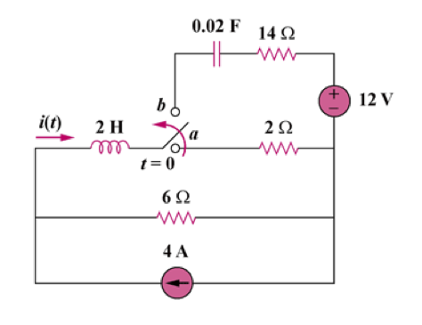

Hey guys :)
I'm just wondering if i'm on the right track for the problem. I have started analysing the circuit, but I'm really unsure of my method of analysis.
The circuit switches from position "a" to position "b" at t=0
and I'm trying to fined i(t) for t>0
from what I understand, I need to determine i(o), which is for the circuit at t=0 (containing an inductor and 4A supply).
Then determine the α and wo for the circuit at t>0
where α = 1/2RC and wo = √(1/LC).
which will indicate the formula to use for the step response, to allow for determining i(t).
my calculated values so far-

The damping factor you've calculated above seems to be the damping factor a parallel RLC circuit. We need the damping factor for a series RLC circuit.
Give it another whirl and see if you find the correct type of damping that the circuit is exhibiting.

You need to develope the ODE for this simple series circuit. Once you've done so you have formulate the characteristic equation which will provide you with two identical roots. (Multiplicity 2)
You know the form of the natural response will be,
\((A+Bt)e^{st}\)
where s is the root of your characteristic equation.
Add this to the forced response of your circuit and you will developed the complete response.
You must use the initial conditions of the circuit to solve for A and B.

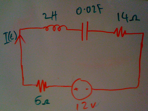

ok i'v started over, and this is where I'm up to.
by current divider in circuit formed by t<0
i(0) = 4(6/8) = i(0+)
voltage divider at t = 0 (my hand drawn cct)
Vc(0) = 12(14/30)
=4.8
by KVL
-12 +VL(0) + Vc(0) + 6i(0) + 14i(0)
VL(0) = 12 - Vc(0) - 4.8 - 6x3 - 14x3
=-52.8V
which looks wrong
a = R/2L = 20/(2x2H) = 5
wo = √(1/ (2 x 0.02))=5
a=wo
i(t) = (A + Bt)e^(-at)
where s1,2 = -a
and B = i(0) = 3A
A = di(0)/dt right???
I'm guessing there is alot wrong with what iv done so far.
if you could explain the things I got wrong so far, that would be amazing

The initial capacitor voltage will be 0V [at t=0-]. Why? Prior to the switch transition there is no means by which the capacitor can acquire any charge. Since Vc cannot change instantaneously, the value of Vc at t=0+ will also be 0V.

Effectively at t=0+ the circuit reduces to an inductor with an initial current of 3A, a capacitor with 0V, a total resistance of 20Ω in series with an equivalent source of 12V.
The same 3A initial inductor current flows in the 20Ω, producing a 60V drop.
With an equivalent source voltage of 12V and the 60V across the series resistance, the inductor must have a 48V drop of opposite polarity to the resistance drop. Keeping in mind the capacitor has zero voltage at t=0+.
So the general solution is
i(t)=(A+Bt)e^(-at)
At t=0, i(t)=3A which will give a value for the unknown A - given the 'Bt' term vanishes at t=0
At t=0, L*(di/dt)=-48V from which, after differentiation and substitution of values, you can find B, given the values A and a are already known.

B is incorrect.
Looks like you might have left out the 2H Inductance value in the solution.
The induced voltage drop in the inductance is e(t)=L*(di/dt)=-48
You seem to have solved (di/dt)=-48 at t=0
