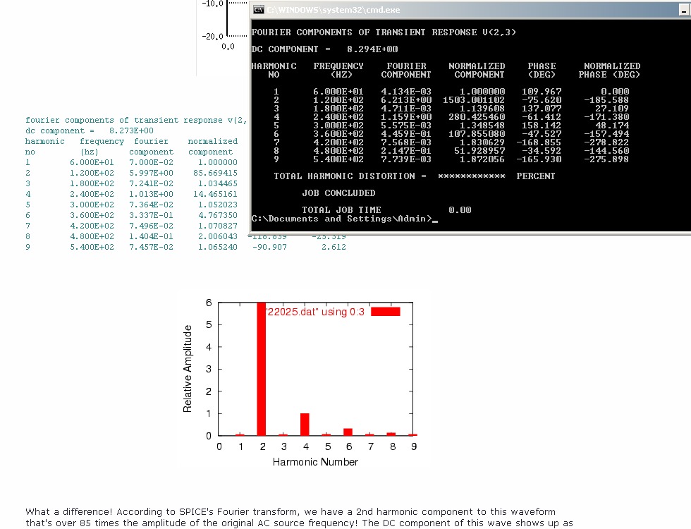

What am I doing wrong in attempts to simulate an example circuits with FFT? Why do my results not correspond to these ones in the book? With earlier simulations everything matched excellently!
Huge thanks for any decent explanations!

FOURIER COMPONENTS OF TRANSIENT RESPONSE V(2,3)
DC COMPONENT = 8.294E+00
HARMONIC FREQUENCY FOURIER NORMALIZED PHASE NORMALIZED
NO (HZ) COMPONENT COMPONENT (DEG) PHASE (DEG)
1 6.000E+01 4.134E-03 1.000000 109.967 0.000
2 1.200E+02 6.213E+00 1503.001102 -75.620 -185.588
3 1.800E+02 4.711E-03 1.139608 137.077 27.109
4 2.400E+02 1.159E+00 280.425460 -61.412 -171.380
5 3.000E+02 5.575E-03 1.348548 158.142 48.174
6 3.600E+02 4.459E-01 107.855080 -47.527 -157.494
7 4.200E+02 7.568E-03 1.830629 -168.855 -278.822
8 4.800E+02 2.147E-01 51.928957 -34.592 -144.560
9 5.400E+02 7.739E-03 1.872056 -165.930 -275.898
TOTAL HARMONIC DISTORTION = ************ PERCENT
