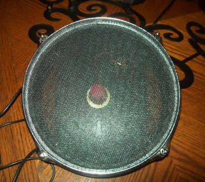

    You could probably get better response from a target "plate" using piezo elements, piezo sensors can be made out of some small piezo speakers you get out of musical greeting cards...... couple that with some op-amp circuitry to amplify the signal/limit output signal, etc..... I use the same scheme in my DIY electronic drum set.
    Actually the same principal idea can be applied to your target as my drum heads, the closer the pellet hits to center, the more response you get from the sensor..... so you can approximately determine where on the target the pellet hit, if used with atleast 3 piezo sensors, you should be able to triangulate the point of impact to a real close approximation....

    and you could also dampen the target plate with the same material some mouse pads are made of, this will prevent the pellets from ricocheting too much...
