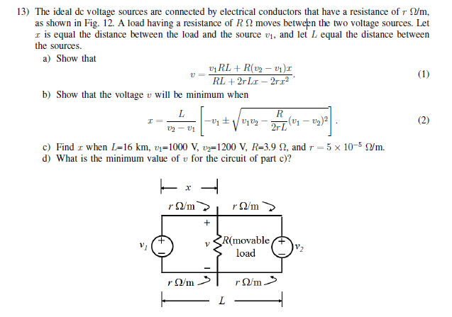

    Hey guys, I have this question that was in a lecture slide.. I have no clue where to start for question a) :/
    [​IMG]
    I know that the r ohms/m is the resistance of the wires per m..thus they give you lengths of x and L.. but where do i go from here? I was thinking super position and neglecting v2 or something then vice versa for v1?

    1,330
    305
    draw a circuit, label everything and you will get three resistors in series (wire1, load, wire2). then calculate voltage drop on load.

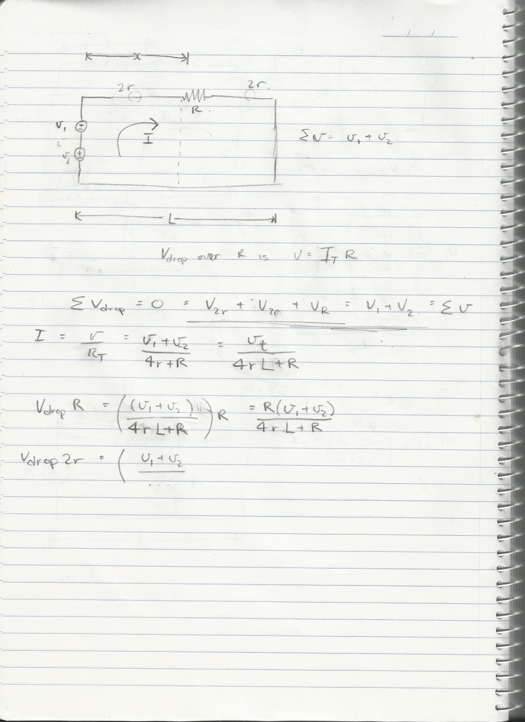

    thanks you for that :) i am just wondering if i am heading in the right direction now?

    No you aren't heading in the right direction.
    In the original diagram the "sliding" resistor R forms a bridge across the lines at the point of connection to the lines.
    If the sliding R is a distance x from source V1 then the line resistance in each line conductor from V1 to the connection point is x*r Ω. The line resistance in each line conductor from source V2 to the point of connection is (L-x)*r Ω.
    Redraw the schematic with the line elements replaced with those equivalent resistances and with R bridging the lines at the connection points. You'll end up with a two loop network which you can then analyze using standard DC circuit analysis techniques.
