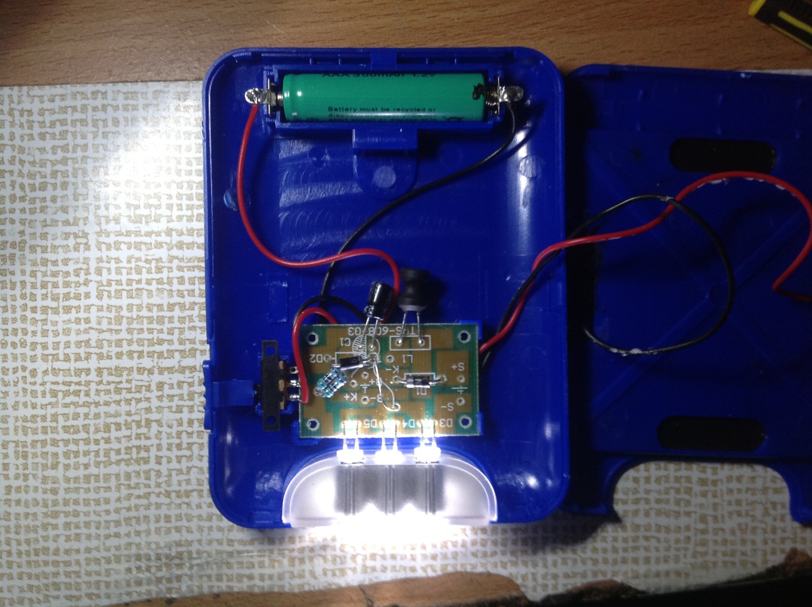

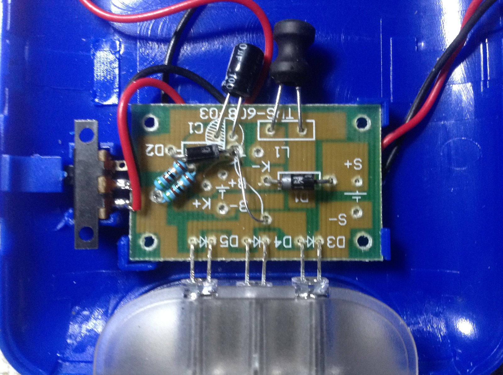

Hey guys, this is my first ever post on this forum and I'm a complete newbie when it comes to electronics, I have not done any classes what so ever regarding electronics (other than some short classes in physics during highschool), just ALOT of reading so everything I already know has been self taught.
I just bought something however because i was simply fascinated by it for a few reasons:
1) It uses 3 white LEDS
2) White LEDs have a forward voltage of approx 3volts each?
3) Yet it runs on a 1.2V AA battery
Now I know current can be stepped up however thats AC, what fascinated me about this device is its stepping up DC voltage from 1.2 to 3.x volts and i simply want to know how it does it.

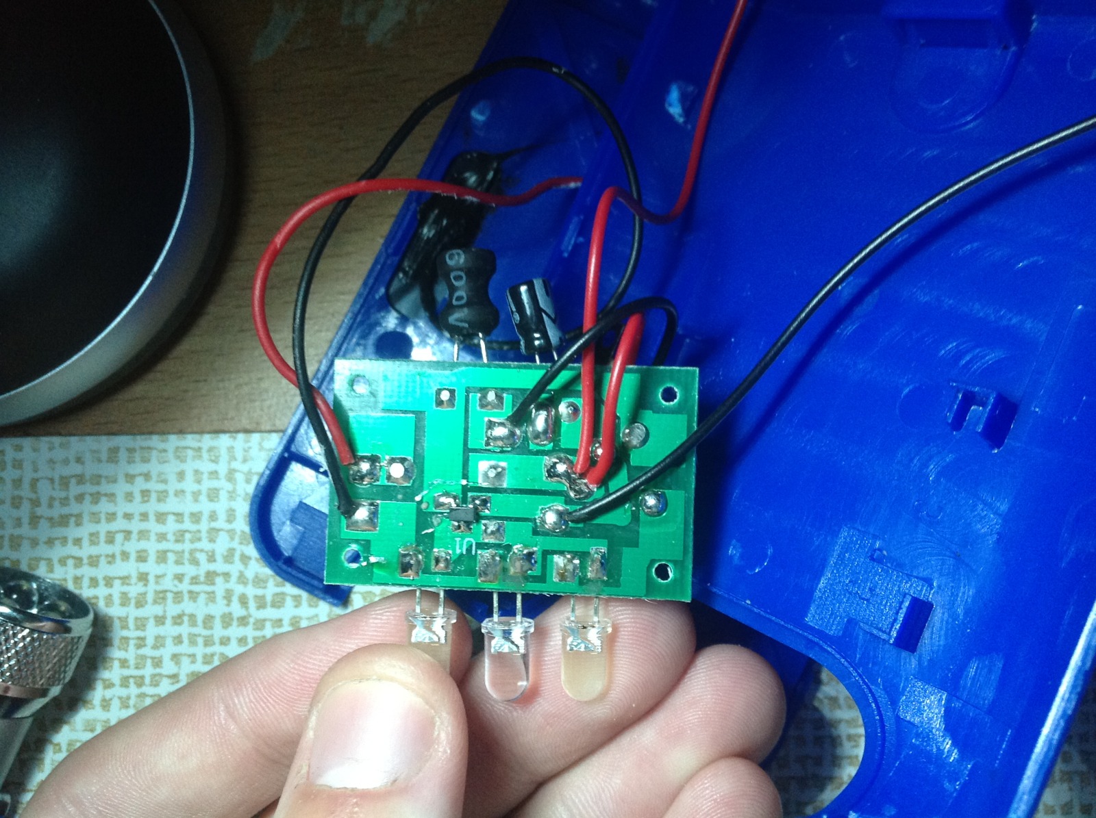

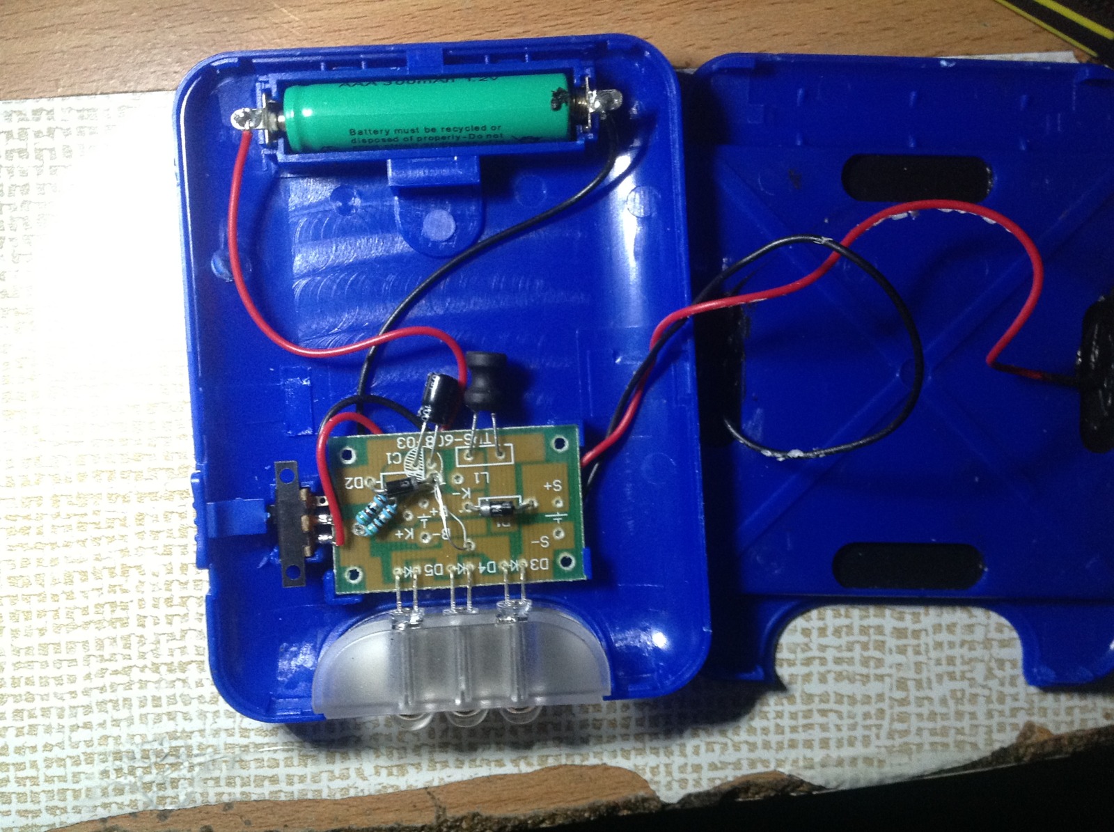

These are the images of the circuit board, if you can make out how it does it, can you please explain how its buffing this specific circuit is buffing voltage? If possible I'd like to thoroughly understand it as I might use such a circuit when I start making my own stuff (such as why there is two resistors there in parallel?)

Solar night lights can light a 3V LED off a 1.2V battery since they have a DC-DC boost converter built into them. That's why there is one or more inductors (L1 is such) on that board. Hard to tell from the pictures but those two "resistors" in parallel may also be inductors.
Here's a discussion of some units I tore down.
To fully understand your device you would have to carefully trace out each and every part and connection to make your own schematic. I can start you off by telling you the 3 LEDs are in parallel, and D1 connects the solar panel to the battery and blocks the battery from discharging thru the solar panel at night.

There is no part 2 and part 3. Everything except the solar cell and D1 make an oscillator. It runs as described in the other post.
The CDS resistance does indeed decrease with increasing light. So as it is used here it keeps Q1 off when the sun is out by shorting the base to emitter (no base current means Q1 is off).
This circuit can increase the voltage thus: Just look at the B1-L1-Q1-LED loop. When Q1 is on it causes a current to (quickly) build up in L1. Then when Q1 turns off this current must transfer to somewhere and thus it goes to the LED. As L1 is a current source the LED controls it's own forward voltage to exactly what it wants to use that current.
