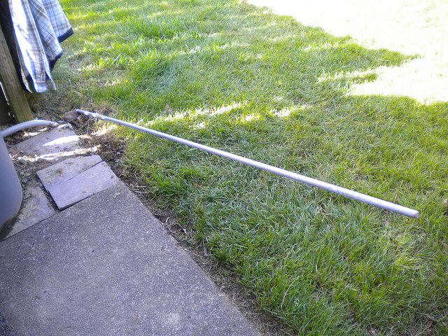

Thanks nsaspook. I'll definitely plumb in a ground, as will be using twin and earth cable, and the light cases are wired for earthing, so makes sense.
Now that you mention it though, I assume that any old conductive metal rod stuck in the dirt will do. I thought I'd earth it up, but hadn't though how.
Anything I need to consider/think about? The conductor, how/where its put in the ground, how deep etc?

I used a standard big box store 6 foot rod. I salt the fence line to kill weeds so I drove it in at an angle near it as this was a additional rod not the primary and there are car sized rocks just under a soil leveling cap the house was built on.

Wow nsaspook, that's a massive rod you got there! But not sure on the mellons!
Does it need to be that big? The mothers house is very old and built on land that is full of massive chunks of very old stone and granite, I think ill have real trouble in trying to get something that deep.

What matters is conductivity. A long buried plate in a trench with a solid electrical connection will work in poor soils. Placing something conductive under and on top off like coal or coke powder and waste iron filings mixed with a Portland cement 50% binder to make a conductive slurry mixture before covering with dirt helps.

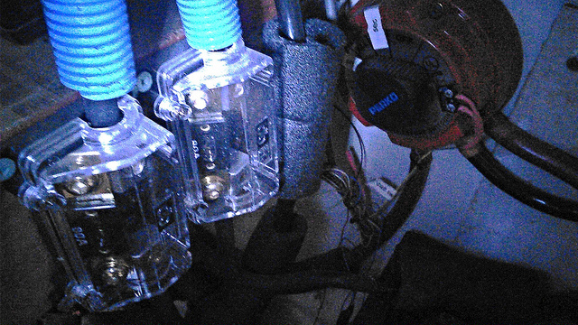

All those photocells and timers use energy from the battery so if I HAD to have it I would use only one for the master on/off switch. One last thing about wiring, use a quality Fuse and holder. I tried to go cheap once with a main 40A fuse for car audio with solar and it looked like this after about a year of heat/cooling cycles loosened up the wire contact screws.

I was pushing 40+ amps into the connector with just a single set screw to compress stranded cable. Not a good setup.
I'm now using marine quality fusing systems.
Regular AGC/MDL type holders/fuses or blade types should be ok at your power levels.
https://www.bluesea.com/products/5024/ST_Blade_Battery_Terminal_Mount_Fuse_Block_Kit
https://www.bluesea.com/products/5018/ST_Glass_6_Circuit_Fuse_Block_with_Cover

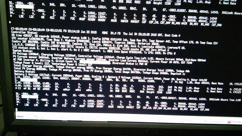

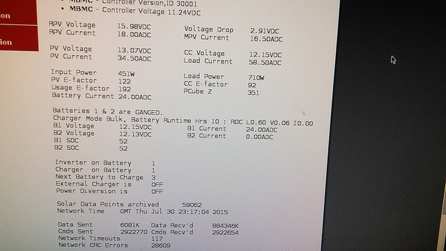

Today I'm testing all the connections with a max load (101F and AC at full blast) with full solar power. The battery bank is taking up the slack.
PIC32 network interface controller
PIC18 solar controller
Looking good so far 0.18 volts loss from the battery terminal to the inverter @ 710W with 2/0 charger cables and a 3/0 battery cables.
