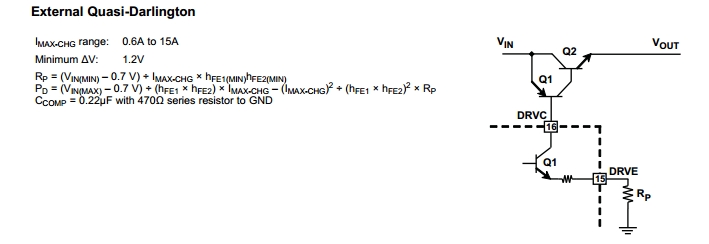

    1. The app note is showing that Rp should be connected to ground due to an internal NPN transistor in the UC2906. [​IMG]
    Could the appnote be incorrect?

    1. The BQ24450 has a better block diagram and shows a current source where there needs to be one for a circuit to work with Rp connected to ground. The UC2906 appnote does not show that. So in that case leave Rp connected as you have it. This allows you to have a lower drop-out voltage across the external series transistor.
