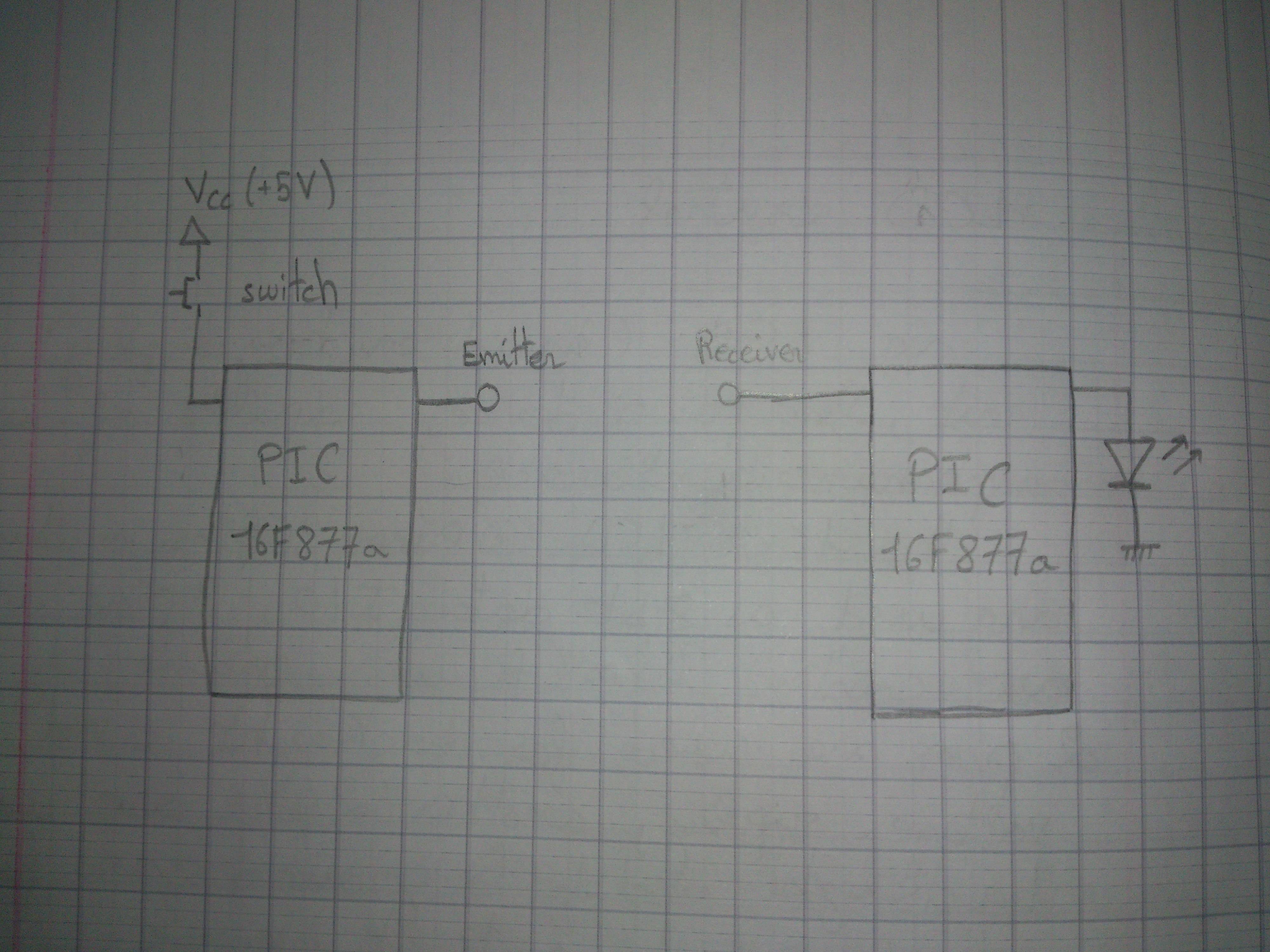

Hello everyone,
Basically it's a small project, I want to emit a 5 MHz frequency signal after i press a button, and light the LED connected to the other PIC as shown in the diagram below
this is just part of the project obviously but need this running before i proceed,
I will need to design the emitter and the receiver myself.

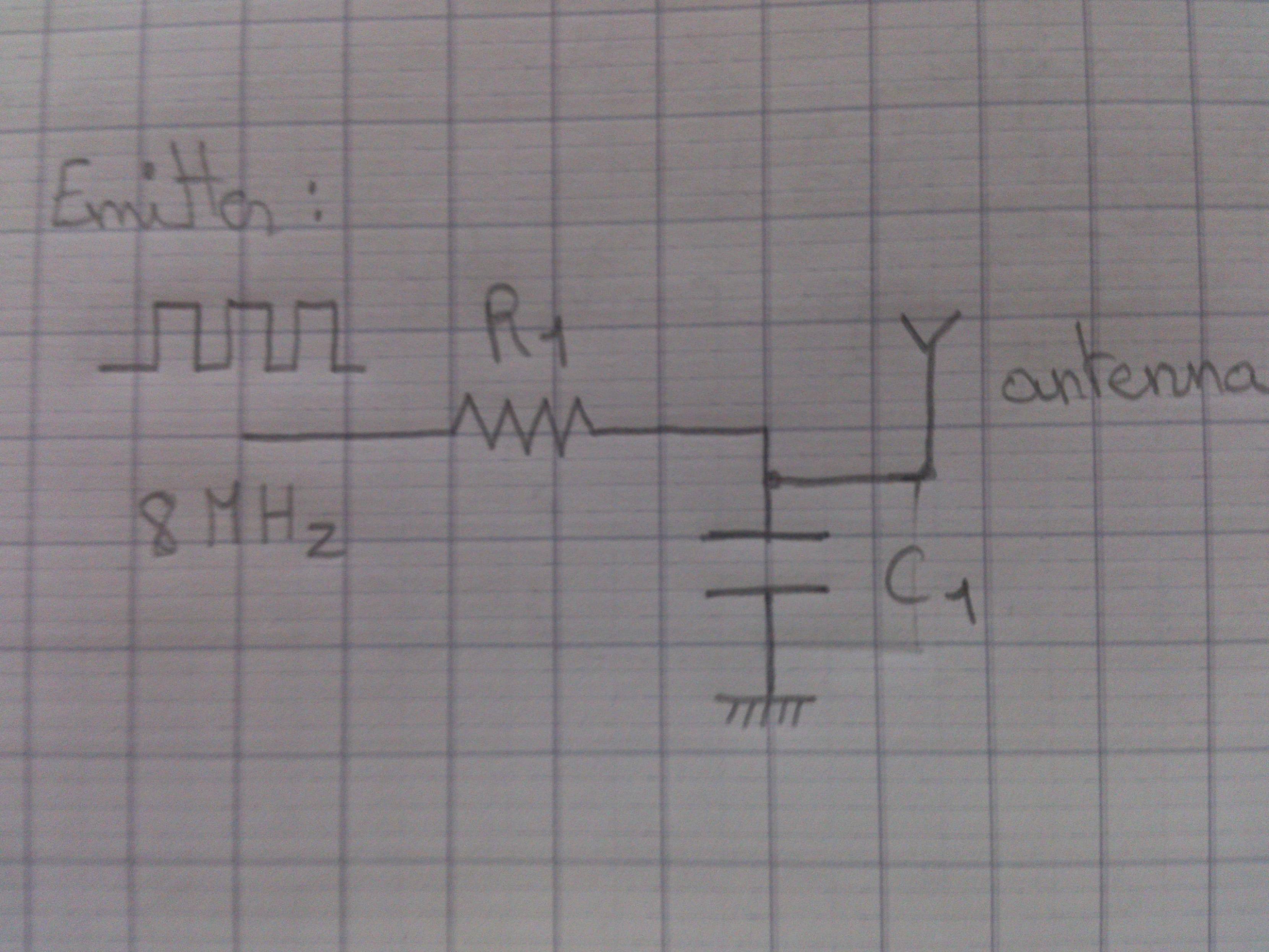

I dont really know how to implement all these since all i know is theoratical but this is what i plan to do :
Emitter :
basically i will output from the pic a waveform signal, whose frequency is let's say 5 MHz and through a highpass filter and should get a sinewave, at least thats the plan.
code for the pic :
( 12.5 microseconds is the period for a 5MHz signal )
I need help in choosing the values of R1 and C1, and before anyone saying " that is highschool level .. " , yes i know, exactly.. i forgot all these thats why im asking

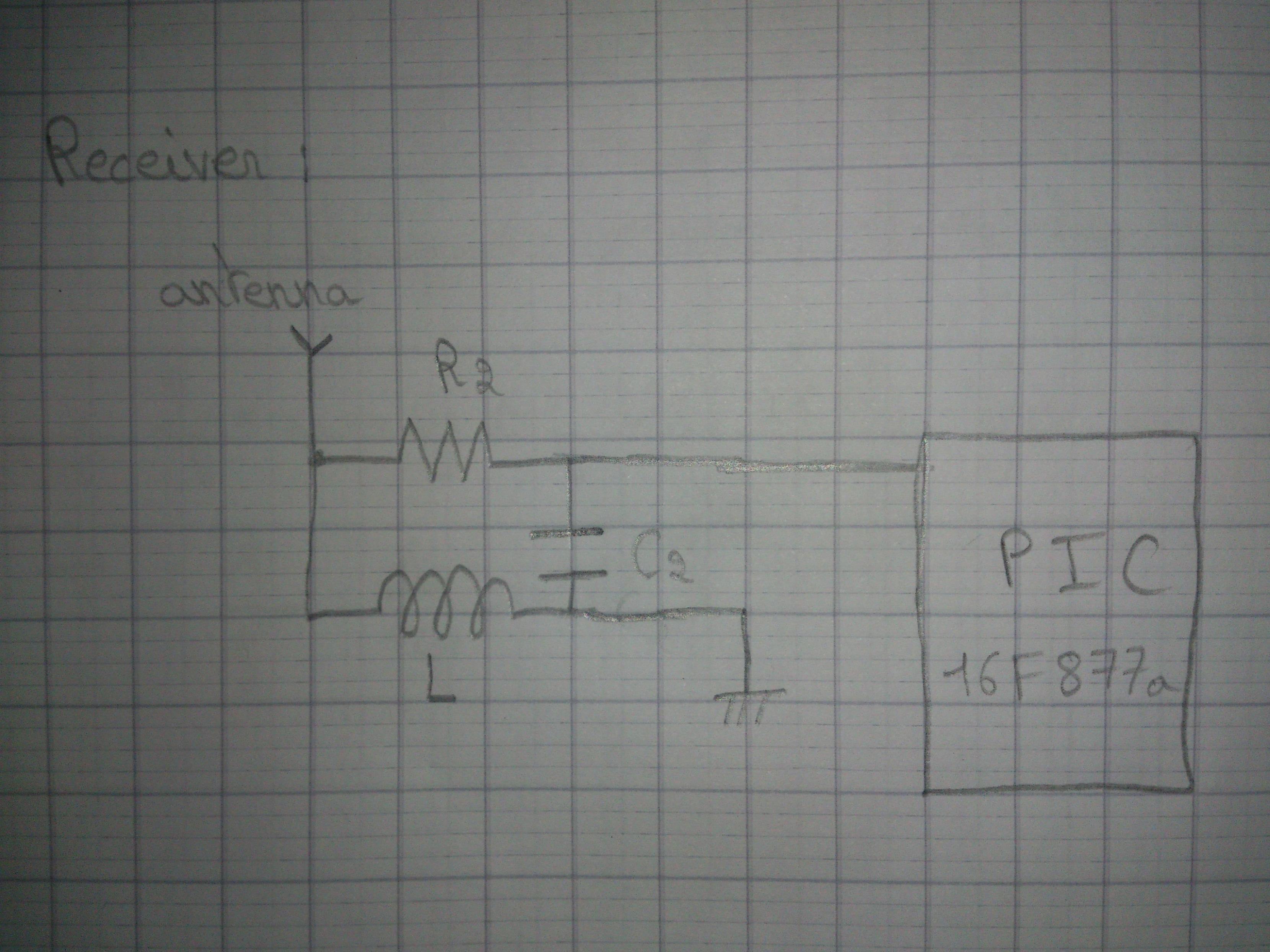

Receiver :
RLC circuit whose natural raisonnance frequency is 5MHz
Thats it basically, I will input the sine wave i receive into the analogue pins of the PIC and when voltage is detected output to the other pin of the PIC. Or maybe convert that analogue signal to DC voltage and input it as digital input if its easier, what do you guys suggest ?
Emitter :
code for the pic :
Rich (BB code):
void main() {
TRISA=1;
TRISB=0;
while ( 1 ) {
if ( PORTA.F0==1){
PORTB.F0=1 ;
delay_us (12.5) ;
PORTB.F0=0 ;
delay_us (12.5) ;
Receiver :
