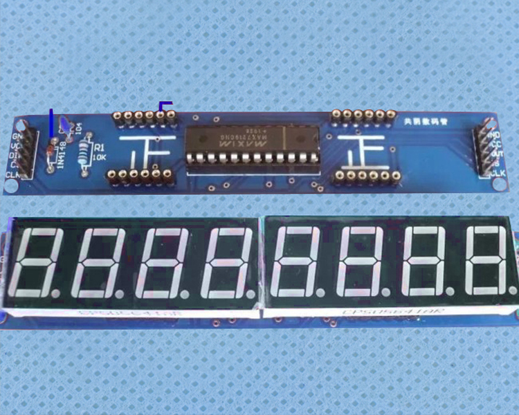

2
The serial port is done in software, it is possible to monitor signals on the pins, and then send data just at the right time but I decided against that.
Instead, each time the display is updated, the controller chip must be reset! Then it waits for serial data. Result is, the display goes blank for 20 milliseconds. Not visible when using LCD but with a LED display, it is slightly visible.
Interface is 3-wire: RESET, DAT and CLK.
Any ideas or comments? Yes I know, hardware serial port would be better.

Your text rambles quite a bit! People might not be sure what the project does or WHY it is a good thing.
If I understand it right, you have made some 4 digit 7-seg modules, with a PIC built in, so it only needs 2 (or 3?) wires to control it from another PIC or another micro. Is that right?
One suggestion would be to make it accept USART serial data, so it only requires ONE digitial output pin to drive all 4 digits. Then the other micro could just send 4 serial bytes to operate the 4 digit display.

I don't understand why it does not keep accepting serial data instead of needing to reset each time the data changes. Is it because you cannot figure out how to multiplex the displays and get serial input as the same time?
Bob
I can but it is too complicated, especially for people who buy these displays.
Yes I can multiplex it, turn off the displays, check for the transition on the master, then send within some time, and also the display must test if clock signals arrive within some time.
With these 16f54 displays, I will use simple as possible serial bus. It needs 3 wires.
Not sure if there is large demand for serial 7seg displays, so it could be worth it to design another with hardware serial port.
JohnInTX

I've used techniques similar to those in AN510 to do software UARTs using Timer 0 to manage timing while multiplexing LED displays (and do lots of other things a the same time).
But RB's post shows that its probably not worth it any more.

Which chip are you using, the 18/20 pin 16F54? What clock speed? How many digits are you driving, 3 or 4?
One method I've used for bit-banged serial RX was to sample the RX pin at 3x the bit rate (34.5 usecs for 9600 baud). With an 8-MHz clock an RX state machine uses ~14 cycles of each 69 cycle sample interval which leaves plenty of time to process serial data and refresh a display.
Would you like some help?
Thanks, I appreciate you offer for assistance.
Generally, I dont do cycle counting or any assembler coding.
And I use a small 22uH coil, not a crystal, I dont actually know the frequency, it could be about 10 MHz.
It is a 20pin TSSOP 16f54.
For asynchronous serial port I'd need a crystal, guess. Coils are cheaper, smaller, and dont need capacitors.
Both 3 digit and 4 digit displays are possible.
It is possible to sell them at 3.98 but I'd prefer $4.98
The chinese displays are much larger, after all.
Best would be to mass produce the carrier PCBs, using blank die's- I could use a 28 pin PIC, and external EEPROM table, so they can be good for any 7seg display.
Preprogram a number of common 7segs into an EEPROM or the internal FLASH, and have PCB pads for another EEPROM.
Guess LED 7segs are not all that important anymore, many people use small TFTs now, low price, and more flexible.
To get back on MMcLarens reply, a future revision likely will be based on a PIC with hardware serial port, and SOIC instead of TSSOP.
The problem with the 16F54 is that it has no interrupt, so if there is a transmission error, the display would hang.
Resetting the controller frequently, it will only go blank for a second or two in case of a transmission error.
