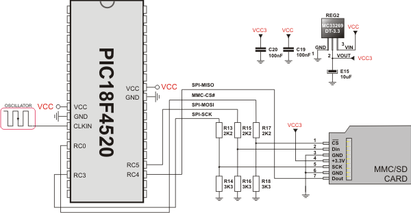

I'm pretty new to PIC programming and I'm trying to interface an SD card with a PIC18F4685. I began by doing a simulation with proteus because I don't have the actual hardware yet. This PIC chip is a 5V and the SD card is 3.3V so I have this extra circuit:
The problem is this doesn't work in proteus unless the SD is directly connected to the PIC. I just want to confirm that this is needed in real life and the circuit is accurate.
