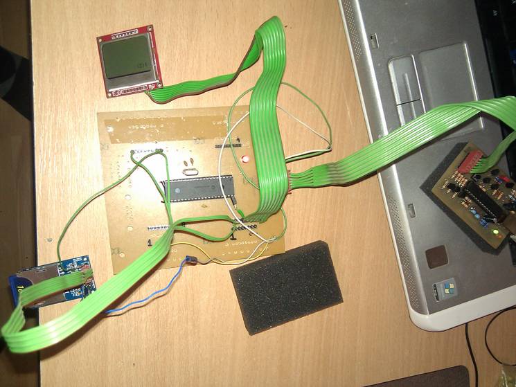

For 3 days i'm struggleing to get done a connection between pic18f4550 and an Panasonic Sd card (16 mb).I have bought from ebay an sd card module for this.
The problem is that my pic is dies when i call any function from mmc library, excepting SPI1_Init_Advanced() or Spi1_Init().
I have connected the pic to sd card module in this way:
CS->RB2.
MOSI->RB0,
SCK->RB1,
MISO->RC7.
This is strange becouse i can't even debug it.
The purpose is to write a txt file with some content in it.And for that i have used the code from this example: http://www.mikroe.com/download/eng/documents/compilers/mikroc/pro/pic/help/mmc_library.htm
What can be the problem?...My compiler?...my libraryes?:confused:..If u have another simple code in order to do this i will be happy do test it.Thanks

It looks like your MOSI and MISO are swapped...RB0 is SDI, while RC7 is SDO, meaning that the SPI output is SDO....since the PIC is the master, this should be MOSI....
EDIT: You image doesn't show up, Yahoo says the link is forbidden....

Also, you do have the connections specified, right? As per the link you gave...
Ex:

I have tried with the mosi and miso swaped but no effect.
I don't understand why my pic dies.It just would not work properly?no?
Also i have tried with
sfr sbit Mmc_Chip_Select at LATB2_bit;
sfr sbit Mmc_Chip_Select_Direction at TRISB2_bit;
AND
sfr sbit Mmc_Chip_Select at LATC0_bit;
sfr sbit Mmc_Chip_Select_Direction at TRISC0_bit;
Image must be visble now.

You have decoupling caps? I don't see them in your picture(which, yes, is now visible...)
EDIT: I see a small .1uF? cap, you may want to add a 100uF cap in there also...

My board is not on MCRL, i don't use a button for that.I reset my pic from PicKit2 software.
My 10k resistor is on the bottom of the board.

Damn... I've got these things to work but if the library code doesn't work... well, then I have little idea what to try next. Do you have an in circuit debugger, and if so does it trace thru the library code line by line? That may give a clue where it "dies."
Dies... that's a curious word with imprecise meaning. Do you mean you need to reset the PIC? I don't work with that compiler or libraries, but does it need heap or some memory defined/reserved? I've had failures due to that.
Does the SD card work in another computer?
Does it still die if you remove the SD card and run the code? The could mean a hardware line short or such.

This microC compiller is craked, in order to let me compile this code that requires more than 2k.
The microcontroller doesn't start when i call a function from this library, even is at the end of the code...

I'm pretty good right now with this.
My problem was that my cracked program didn't generate the hex corectly.
The card works properly, i can create files, directories...etc.
