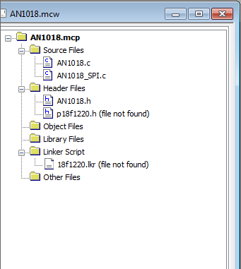

    In order to write to the 25LC1024 external EEPROM I followed a tutorial from microchip here. The first problem is that this tut is written for PIC18F1220 and I use PIC18F87J11. So upon opening the project I get two files not found error, but I simply ignored them.
    [​IMG]
    I copied the file AN1018.h and AN1018_SPI.c to the project I am working on, and I copied some piece of code from AN1018.c file.

    As a start you must include include the correct header and lkr files with the correct one for your PIC. That will say replacing every
    #include <p18f1220.h> with the correct one for your PIC(in both C files). And the same goes for the lkr file. I would HIGHLY recommend building a new project. Using the project wizard in MPLAB, and then include the correct files. Perhaps this document and section 3 may be of some help. http://ww1.microchip.com/downloads/en/DeviceDoc/41370C.pdf
    Then the next step would be to find out which pins that are used for SPI on your PIC. Then verify the #defines in AN1018.h file and modify according to your PIC. And also the TRISx setting in the init function (AN1018.c)
