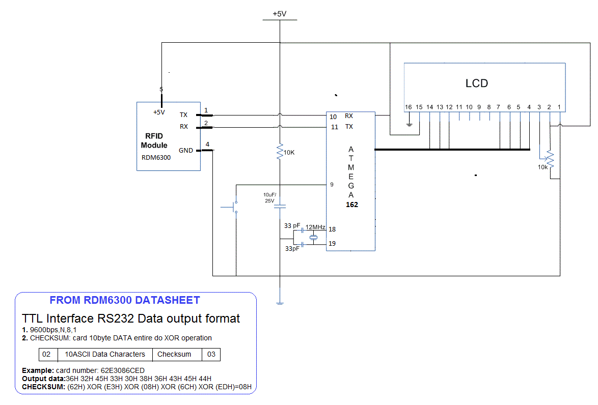

Hi,
I have interfaced RFID and atmega162 as in picture , but I am getting garbage with blank spaces, hypens on lcd , please see my code and tell me whats could be the problem, Hoping for your help.
Please have a look on schematic and also coding for USART. What could be the problem that Y i getting garbagr on my lcd.
Coding I used for USART for getting input from rfid and displaying on LCD, all other lcd functions are not included in code below.
I initialized my uart using the code below I got it on internet.
Code:
UCSR0C = 0b10000110;
// Enable Tx and Rx, disable interrupts
UCSR0B = 0b00011000;
// Normal speed, disable multi-proc
UCSR0A = 0b00000000;
// Baud rate 1200bps, assuming 1MHz clock
    UBRR0L = BAUD_PRESCALE;     // Load lower 8-bits of the baud rate value..
                            // into the low byte of the UBRR register
    UBRR0H = (BAUD_PRESCALE >> 8); // Load upper 8-bits of the baud rate value..
                                  // into the high byte of the UBRR register
I am getting data from RFID using
Code:
while ((UCSR0A & (1 << RXC0)) == 0); // Do nothing until data have been received..
                       // and is ready to be read from UDR
    return(UDR0); // return the byte

Have you double checked your baud rate?
Easiest way to check baud rate is to connect it to a computer and use terminal.
Also did you test your LCD?
When wrongly initialized they will produce corrupted data.

Thank 4 ur reply,
I connected my RFID with PC and set 9600 baud on pc , I was getting 12 charachters on Pc , i think those were rfid tags,
I am printing "Hello World" on LCD and thats working perfectly.

I forgot to mention that I have used this code in my program,
Code:
#define F_CPU 12000000UL
#define USART_BAUDRATE 9600
#define BAUD_PRESCALE (((F_CPU / (USART_BAUDRATE * 16UL))) - 1)
Could the problem is because of crystal or fuses?
I am getting 1.25 sec beep on _delay_ms(100);

The frequency you have there could be wrong, that is why i asked you to check it.
I remember back when i used MPlab i had to choose the Crystal, else it would use something else.
naqirizvi
Joined Jan 30, 2015
14
So How could I select External crystal.
Do i need to change fuses? Or just in programming?

Ok, Well I set my fuse low value to FF problem was still there,
then I set it default now a new problem arise , I am getting beep without delay. nothing is displaying on LCD.
normally after a beep lcd shows "Welcome"
but now lcd has got boxes, and beep is continous
naqirizvi
Joined Jan 30, 2015
14
Thanks Man , I finally got it working,
I go through datasheet. And set my lFuse=FF(for selecting external clock >8Mhz)
hfuse=99(default value) eFuse=ff(default value)
and also included
Now my controller is working on 12Mhz clock. Also reading my RFID tag and displaying on lcd.
But I am also getting garbage before and after tag. but I am able to get 100% correct tag.
If you know who could i remove garbage then tell me please.
