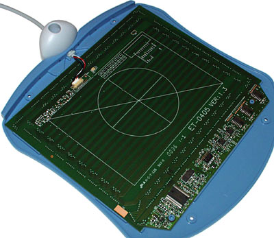

    Hi-
    I have a Wacom digitizing tablet, about 10 years old. It worked fine, was stored well for about 5 years, still looks like new. So the other day I pulled it in to the power source, smelled a burning, quickly unplugged it and now it won't turn on. So, I understand I have fried it in some way. I called Wacom to ask for help/repairs and they just said it's 10 years old buy a new one. Can I repair this? I've opened it and I can see just past the power connection there is a burn mark on the case. The rest of the panel looks okay? Any chance of repair?
    Thanks for any help or thoughts on this.

    not much to go on, but i can recommend following typical troubleshooting process. you'll need to remove the damaged board for a good eyeball and ohming out. something likely shorted out, or component failure caused an excessive current draw on the power source lands. with some luck a fuse blew down line. ohm out the load to see if there is a short, or extremely low resistance. let us know what you find.

    The first things I would suspect are any electrolytic capacitors in the power supply section. They go bad over time. Look closely at the tops of the caps; if you see any that are bulged, have tiny holes or the tops blown clean off/open, you've found a problem.
    There were a few Asian companies that made (and are still making) electrolytic caps with electrolyte that is far too concentrated. This results in early failure of the caps.
    If you want to restore it and have it last a decent length of time, replace ALL of the electrolytic caps with new ones of recent manufacture from a reputable distributor, like Digi-Key, Mouser, Newark, Allied.

    I don't see anything like what I am used to recognizing as a fuse. When I open up the tablet inside it looks a lot like this: attached photo. Just past the input area is a small black chip and this is where the burn occurred.[​IMG]

    Well, I found the user's manual in PDF format for your tablet. Unfortunately, I didn't find a schematic, but I did find out that it's powered by either your USB port or keyboard/mouse port.
    Looks like the board is all SMT (surface mount technology) which is going to be tough for a hobbyist to troubleshoot/repair, particularly without having a schematic to refer to. It's likely that the PCB is multilayer, which will make things even more difficult.
    Can you post a high-resolution photo of just the area where the burn occurred? Say, a 2"x2" or 3"x3" area?

    I see; looks like "ZD102" is the reference designator. The "ZD" indicates to me that the item is a Zener diode; of what voltage would be tough to tell exactly if the numbers are burned off. The three IC's that I can see are all 74HC4051; CMOS multiplexers/demultiplexers; they have a recommended operating range from 2v to 6v. The little tan rectangles with labels like "C213" are ceramic capacitors, and are connected across the IC's Vee/GND and Vcc/GND pins.
    Since the ref des ends in "102", that tells me there is another Zener diode somewhere else on the board. See if you can find "ZD101", and read the tiny lettering on it.
    It looks like there was something else on the lower left corner of the white-outline rectangle inside the circle that is now a blob of solder. Can you get a better close-up of just that area?

    I posted two more photos on the blog. I did find one ZD101 in the middle of the board. I circled in yellow. I wasn't sure what tiny lettering you meant by the ZD101 so I hope you can see what you need on the photo.

    You do have a fuse .... labeled F102, near the switch on the right hand side.
    I suspect anything in the 100 series is the power supply ... so I would investigate that area first.

    OK, the ZD101 marking in the middle of the board is offset from where ZD101 actually resides, as there wasn't room to put all of the markings where the parts actually go. If you look at the attached, ZD101, you'll see the actual part of interest circled in red, down near the single blue rectangle (which is an inductor.)
    What are the numbers and/or letters written on top of ZD101? [you said 512]
    You'll probably need a magnifying glass to read them. [perhaps you didn't!]
    Note how ZD101 looks physically - a three-legged critter. ZD102 looks like it was blown in half!
    It looks like your tablet gets it's power via pin 3 of the connector next to ZD102. Is there a power supply/wall wart in addition to the RS-232 connector?
    (ETA)
    512 is a code for a Philips PZM5.1NB2 which is a 5.1V 0.3W Zener diode. I suggest that it's likely that both ZD101 and ZD102 were the same, but we don't know for certain yet.

    I know I used the wrong adapter. I used a 15V and it was too much. Of course I didn't know this until after it burned.
