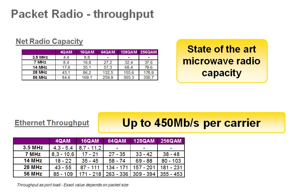

    Hello,
    If we consider a 8Ghz Microwave Link. Which is currently running on 4QAM modulation and 28Mhz channel spacing. What affect will be on the overall link performance specially the Receiver Sensitivity and Capacity, if we change the modulation scheme to 16Qam or 256Qam?
    Detailed answer will be helpful as my concepts are not very good.

    You mention that increasing the number of sub-carriers from changing the modulation scheme from 4Qam to 256Qam will drastically decrease capacity. But in most microwave radio's the increase in modulation scheme (higher) results in more capacity. For example here is a page from a brochure which mentions traffic capacity as per modulation scheme and channel spacing. http://min.us/jbeAqO.png
    Can you please clarify this.
