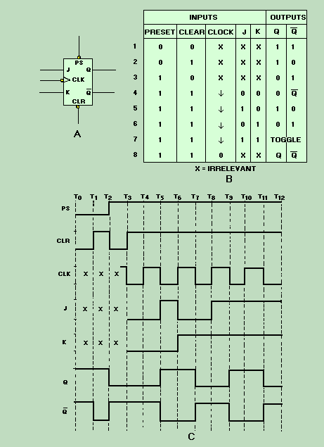

Hey guys, i am just a little confused with the opeation of a JK latch (or flip-flop for that matter.) We were given a nand gate implementation (please see attached file) ages ago and i am trying to study the thing again but cant see how the latch is stable in this condition: Say for example, the enable input if high (in the picture i attached, i forgot to add in the vcc for the enable input but assume its there and its high ;-) anyhoo) and both J and K are both high. Also, the asynchronous preset is low so as to preset the device and the asynchrnonous clear is high. So when this happens, the Q output is high which feeds back to the K input. As said, K is high and so is enable so if Q is also high, this nand gate should go low, making Qbar high.(All the while the asynchrnonous preset input is still left on low) Am i right in saying that the Jk latch is unstable like this so its needs to be in a master-slave configuration or use a level trigger device in tandem with it? If this is correct, does the level trigger device have to be made such that the enable's high duration is very short so the circuit wont oscillate?
All the rest of the circuits states i am happy with i think.
Thanks!

Well i am probably wrong about this but i just want to know where i am going wrong. As said above, i think that when the preset is low such that the Q output will be high, this will feedbad to the K input NAND gate. If, at this time, the k input happens to be high as well as the enable input, then all the inputs to the K input NAND gate will be high so the output of it will be low so then Qbar will also be high which isnt allowed...... ?????am i missing something here?

set j,k, preset,clear to one and clock it, at the negative of the clock signal it will toggel. this will cause your oscillations if im not mistaken.

According to my teacher, i am right, and its called the hazard condition which needs to be avoided, by using an edge triggered device or a master-slave configuration. (just found out today)

This problem can be observed with a test setup that can move changes on the JK inputs relative to the clock edge. As the setup and hold requirements of the flip-flop implementation are violated, all manner of metastable behaviour can be observed including, but not limted to 'runt' pulses, invalid states, long recovery times, and so forth.
As likely as such violations are on the inputs to syncronizers it really is a wonder that stuff seems to work as well as it does.
