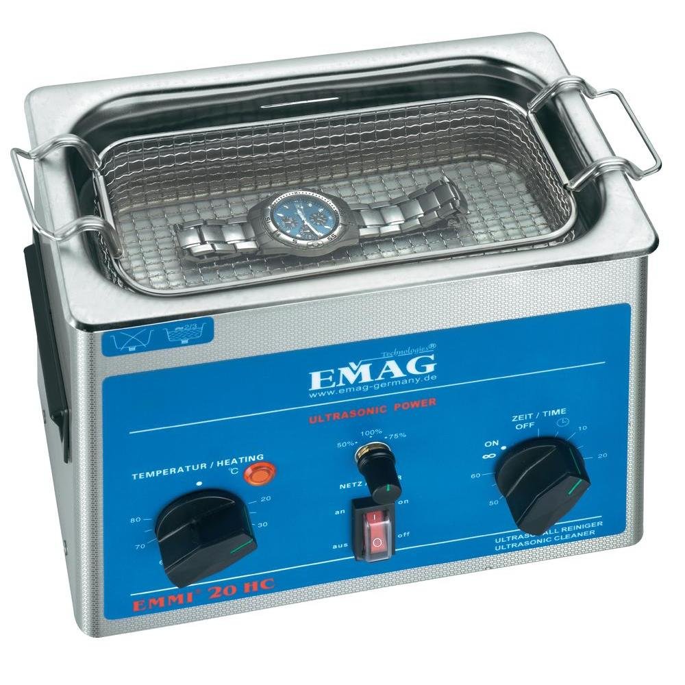

I want to make something like this:
http://ecx.images-amazon.com/images/I/71YmvtL6nnL._SL1000_.jpg
