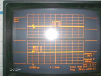

    Well I just got out my oscilloscope to debug this (its a LeCroy 9400A, so its not light) and taking a look at what was actually going out was quite a revelation to me. Here is basically what I saw:
    If I saw the following hump pattern on the scope: long, short, short, short
    I would see the following from the microcontroller: short, short, short, long
    Now it is obvious why there was a frame error: the microcontroller was expecting something different at the end.
    EDIT: Ok, now I really don't know what to think. Here is a 'u' (comp bottom, pic top):
    [​IMG]
    Maybe the PIC is flipping everything upside down?
    END EDIT
    This explains why the U's were showing up properly, but it does not quite explain why text was received properly. Has anyone seen this before? Is it my USB cable?

    Yes. I am using a MAX232. The signals shows in the picture are actually the RS-232 level signals.

    Can't quite follow your "humps", but do you realize that the MAX-232 inverts the signal between the PIC and the serial line?
    This might explain "short, short, long, long" or whatever.
    The start bit on the PIC will be a high pulse, on the serial line it will switch from positive voltage (generally about 8-9 volts) to a negative voltage.
    What you need to look for is the length of time of the pulses.
    Oops, you added a picture while I was writing.
    Send a capitol "U" instead of a "u". 0101010101 instead of 0101000101, including start and stop bits.
    Don't worry about manually inverting. The PIC and the MAX-232 do what you need to make the signal correct. Just realize that high is true on the PIC, low is true on the serial wire, and the low-order bits are transmitted first (between a start and at least one stop bit).

    @DonQ: Each pulse in the capital U coming out of the PIC and the PC was exactly 800uS which translates to 1200 baud which is what I was expecting (SPBRG(H) = 9999 @ 48Mhz). I used the lowercase u for the picture because the uppercase U told me the baud was correct but didn't explain why my characters were garbled when they were echoed back. I noticed that if I shift over all the pulses coming out of the PIC over 800uS (one bit), they make a perfect inverse of what is coming into the PIC.
    Oh, btw I can't measure the output coming right out of the PIC...only the output coming out and into the MAX232 from the serial port. This is because of my board design which doesn't happen to have a via on the RX and TX lines coming out of the PIC and the entire thing is surface mount. *facepalm*

    I can't see your picture well enough to tell much, but these are obviously two entirely different characters. But the signals are so compressed, you can't read the baud rate.
    Set the horizontal so that just a few bits of what is coming out of the PIC will show on the screen. Then measure the time per bit as precisely as you can. If the PC, for example is set at 9600 baud, but your PIC is actually running at 9934 baud, it won't work. So you have to see that it is set correctly by measuring it.

    And... the "mark" state in the 'scope traces in the first post show that the polarity on both serial lines is correct.
    So still... Don't try to invert your signal.
