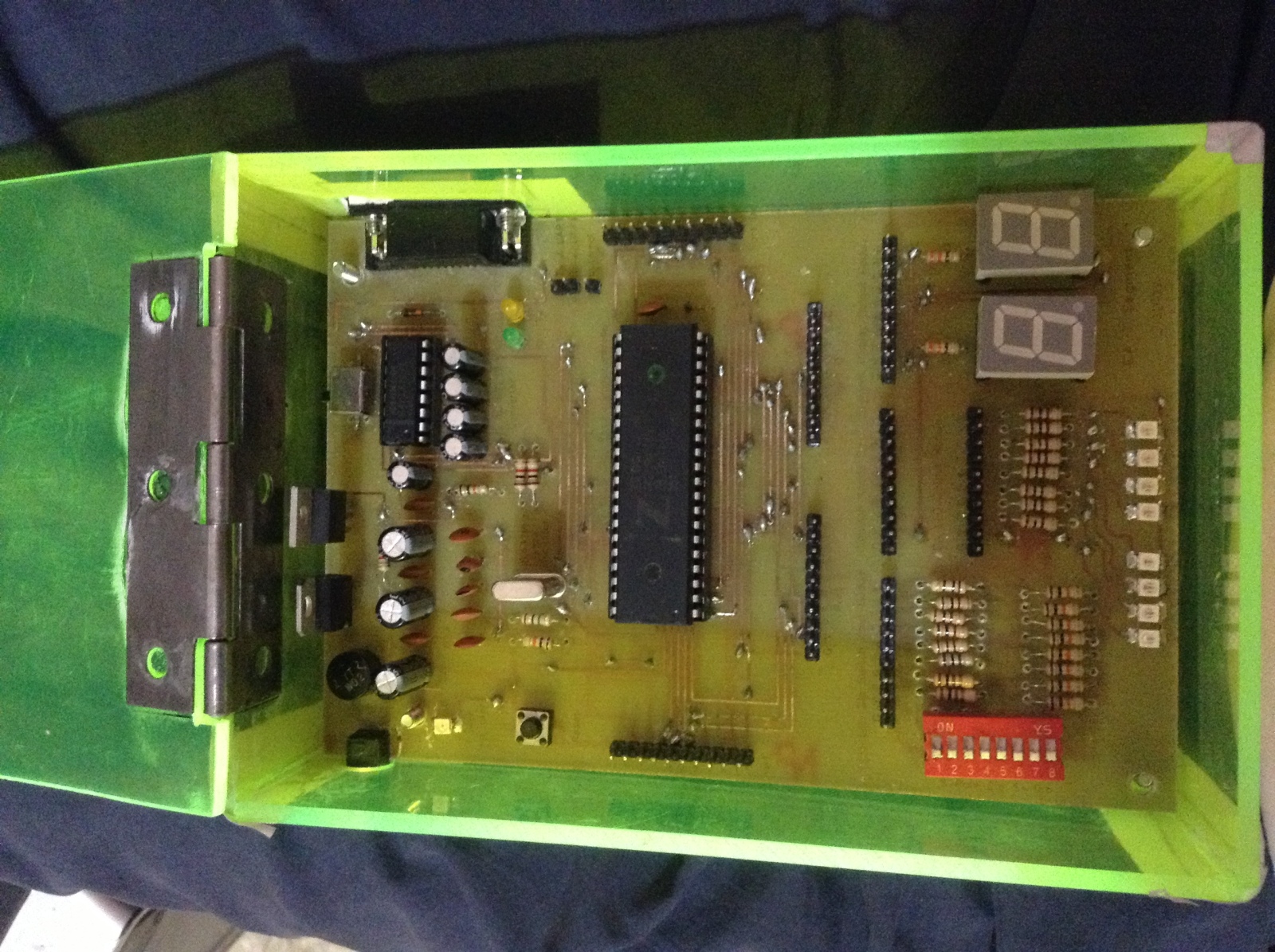

I've made a Zilog Microcontroller Module (for Z8F6421). It has 4 ports, namely: PORT A, B,C,D.

hang on mr. skeptic. XD. I am currently uploading a clip onto youtube. I programmed the output one by one. I mean, no patterns, no for loops, no shifting of bits. As in One Line of codes per shift of bits.
So what I am asking from the start is... the pattern for this output, the shortcut. :)

djsfantasi
Joined Apr 11, 2010
9,163
Let's see... first, I would think of how to stop "shifting" at one position greater than the last loop...
Secondly, I would think of how to keep the previous shifted bits set. I can think of two ways. One is to save the previous loops result and setting it after each shift and another way is to not change it in the first place. Maybe by other operations other than shifting...
Note one operation affects the entire register while the second, although perhaps more costly, preserves your previous work...
There are at least 2 or 3 ideas in here for you to think about. I hope you find them useful...
