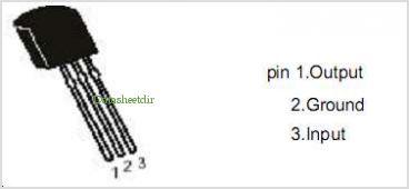

  7. Jony130
    AAC Fanatic!
    Feb 17, 2009
    3,993
    1,116
    All BC547 (no matter from which the company ) has the same pinout.
    In fact all BC5xxx has the same pinout
    [​IMG]

  9. t06afre
    AAC Fanatic!
    May 11, 2009
    5,939
    1,222
    No not all transistors have the same pin-out. The golden rule in electronics is to never assume anything. But check with the data sheet. As a good example. The common 7805 regulator is also available in a low power variant. The 78L05. You should think that these have the same pinout. But this is not the case. Not that I have done THAT DUMB mistake ever...[​IMG] But so you do not get confused. A BC547 in the same package will be compatible across manufacturers
