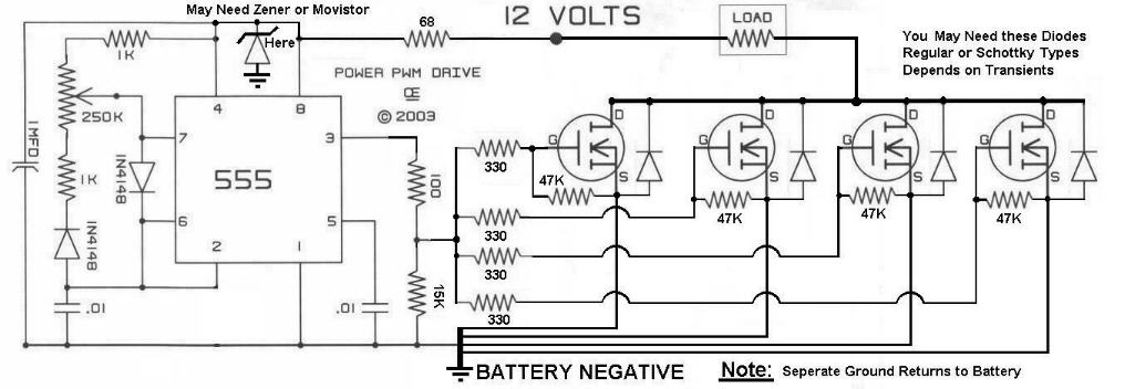

Hi I am building a high current PWM for H2=O generation. I'm using a linier power supply that I built from rewiring a microwave transformer, a bridge rectifier and a couple of caps. I've got 17 volts at 30+amps. I'm not at all good at design yet. I found a nice schematic for HHO generation but have a couple of questions bugging me. Down stream of the load he is using bank of Mos-Fets for the modulation. I've built a pretty good driver using a 555 that I'm able to vary both the duty cycle and on off time. I intend marry this in to the Mos-Fets he uses to actually pulse the load. He advises the use of Schotty diodes in parallel to the Mos-Fets. My question is why are they there and how do I calculate the size of them? My text books tell me what they are but not how to apply this knowledge.

PWM works great when you want to do things like dimming lights, heat control, motor control, etc but not so well for your purpose, when it's just pure PWM. There's nothing to limit the maximum current except for the resistance of the wiring and the MOSFETs when they are turned ON, and when they are OFF, there is no electrolysis action; so with PWM you are toggling between two undesirable states.
You really need a current-mode PWM controller with a heavy-duty inductor that keeps the current relatively constant.

OK Sargent As I have gotten this far can you point me in the right direction to fabricate a good heavy duty inductor? And also Why the heck are those Scotty diodes there?

The Shottky diodes are to protect the mosfet from having the wrong polarity applied to it. Where you're going to get the wrong polarity out of a 12 volt battery also escapes me.

You haven't given a target current yet; what kind of current do you want to maintain through your load?

The Schottky diodes are there to protect the driver transistors from back emf if your load has inductance. If the load is purely resistive then you would not need the diodes.
Also many power MOSFETs have the diodes built in.
