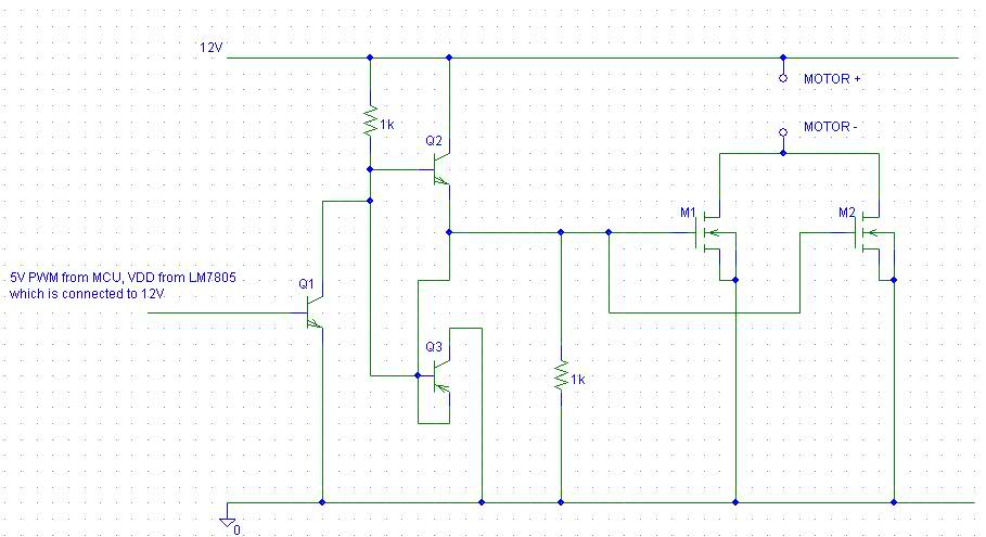

    and I am running into a problem when trying to drive a high powered 30A motor.
    When i attempt to drive small fans, the schematic works just fine, but I run into a problem where my PIC18 is held in reset.
    I am assuming it is because the 5V PWM line is drawing too much current from the PIC18. I think Q1 is somehow leaking current from the base and emitter which is causing the PIC18 to be held in reset.
    When I disconnect the wire going to the base of Q1, the motor runs at 100%, the MOSFETs are fully on and my PIC18 runs. However, when I connect the wire again, the PIC18 is held in reset and does not run anymore.

    a few comments:
    1) there is no place for q3.
    2) q2 is a pnp.
    3) you need to limit the current going through Q2 when Q1 is conducting.
    try this one.
    if you are running at high speed, I would reduce the 1k resistor from the gates to ground to maybe 220-330ohm.

    You had the PNP transistor upside-down. The NPN transistor was correct. The two transistors are supposed to be complementary emitter-followers.
    The input must have a resistor in series with the base to limit its current.
    Each Mosfet needs a low vaue resistor in series with the gate to prevent VHF or UHF oscillation.
    I couldn't get rid of the Chicken-Pox dots all over your schematic but I cropped it a little.

    yes thanks that was the intended circuit. I drew the schematic in pspice and my version has the PNP upside down with the emitter at the bottom, so I had to wire it up funny.
    but the way you drew is how I have my board set up right now, minus the 22ohm resistors on the gates of the mosfets.
    and like I said before, my MCU won't run with this configuration. I'm not sure what is the problem, but it seems to be held in reset mode or a safe mode for some reason. when the input to Q1 is connected and the motor is running 100%.
    when I disconnect Q1, the motor still runs 100% and the PIC's program begins to execute. I have an LED connected to the PIC and I have the LEDs blink a certain pattern so I know that the program is being executed or not.

    1) you don't need that 1k resistor going from the gate to ground in a totem pole set-up.
    2) make sure that you have that 1k resistor to the npn's base. or you run the risk of overloading the mcu - which sounds like is what you have.

    a simple darlington npn with two resistors should suffice here. one resistor as load for npn (+V to npn collector) and the other on its base to pic. perhaps 1k on base and 100 on the collector. connect fet gates to npn collector. this flips the pic signal over.
    with a hfe of 100 (low for a darlington) the base shouldnt be more than about 1.2mA. with a hfe of 1000 base current should be around 0.12mA.
    if you want little to no pic output current then use small fet to drive the big motor fet's, etc. but depending on pic output stage you might need pull-up or pull-down resistors on the small fet gate.
    if the pic is always in reset mode then perhaps we need to know what the output stage of the pic really is, etc.
