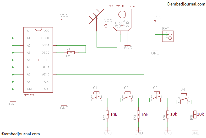

Pull up or down ? I'm confused
André Ferrato
Joined Apr 5, 2015
215
Hi guys, just tell me if i'm wrong. I have the following circuit, the 10k resistor are used to pull down ou pull up the encoder ? The way i see it, is that when the switch is NOT pressed, current goes through the IC from the Vcc passing into the internal resistance and them into ground. When the switch IS pressed, the current will go through the internal resistance and them the 10k resistors ? Because the way i see it, is that for this to make sense we would need a Vcc connection near the switches. Am i wrong ? I'm new to this.
André Ferrato
Joined Apr 5, 2015
215
So i take off the 10k resistors and what is happening is that when the switch is NOT PRESSED, there is no path through that pin, so the pin is low ? When i press current goes through the pin and make it high ?

Download and read the data sheet.
Both the data inputs and address inputs are active-low with internal pull-ups. The switch should pull to ground when asserted.
With the switch open, the pin should be high. Switch closed pulls the pin to gnd.

Look at the pin description for this device on it's data sheet. It says:
"Input pins for address/data AD8~AD11 setting
These pins can be externally set to VSS or left open"
So you either set them low or they set themselves high if left to float.
You may be just fine by leaving the 10K resistor in, check if they truly go low when you press a button. If they don't go very close to ground (say .25V max) then replace the 10K resistors with a short.
"Simon sez" the current will be just fine.
(Simon is the data sheet.)

They will draw less power when the pin is floating (and pulled high internally) than when you ground it with the switch (with or without the resistor). But it is designed to operate that way.

I understood now, i get really lost reading datasheets, and still dont know why they go low when the switch is pressed. Can someone show me some numbers ? Like when i'm using a 12v battery, what happens to be high, what happens to be low. It would be nice just to see. To clarify, i understood the concept.

The HT12 datasheet indicates that the inputs are pulled up internally with 150kΩ resistor (nomimal). Hence you don't need pull-down or pull-up resistors. A simple switch to GND will input a logic LOW.

When you press the switch, you are shorting the pin to the 0V (the "common" or the "ground") which is also the negative side of your voltage supply. Thus the voltage on the pin under those conditions is oV, which is "low". When you release the button, there is a pullup device (could be a resistor but is probably actually a MOSFET) inside the device that pulls the pin toward the Vcc supply voltage, thus taking it "high".

I am afraid the the OP is forcibly trying to label those resistors as "pull-down" (or pull-up) what they actually are not. If he moves them to the pin, then they would be genuine pull down ones.
Here, what actually pulls down the pin is the switch.
