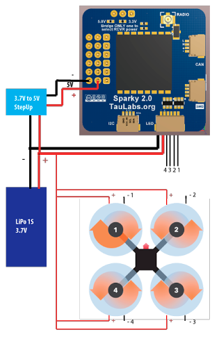

I am building a custom drone, the setup is very simple. I have a flight control board, 3 motors, a battery, and a 5V step-up circuit for the board (it needs 5V whereas everything else is happy at 3.7V). This is the gist of the setup (except one less motor):
My problem is that I am seeing a drop in voltage between the positive junction of the battery, the board + all the motors, and one of the negative terminals of one of the motors (trying to measure the voltage which the motor is getting). What I'm seeing is that it starts around 3.3V, and gradually drops to below 2.8 within the span of 30 seconds.
Through various tests I have confirmed that the setup is correct, the battery is fine (tried a bunch, they're all fine), the motors are fine and the board is fine. That only leaves the wiring. I am clueless as to what could be causing this drop in voltage. I have learned that an increase in current would cause a drop in voltage, so I came to the conclusion that I must have a current "leak" somewhere?
Thank you in advance for any help and any insight anyone can provide.
PS: If interested here are actual pics of the setup: http://imgur.com/a/1BXkM though you can ignore it if it seems like a mess, it is essentially wire for wire with the schematic above.
