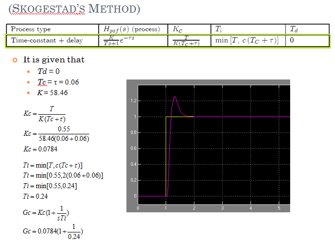

Hi t_n_k, thank you very much on helping me until now :).
Ya, i had work out my transfer function and apply it with Skogestad's method and found that it had less overshoot compare to the Z-N.
Uploaded with ImageShack.us
The pink color is the Z-N method and the yellow color is the Skogestad method.
Is it prove that skogestad is better than Z-N at this transfer function?

Since we are showing different methods, I thought I would post a solution using the gain and phase margin rule GM=12 dB and PM=45 deg. I just did a quick optimization which resulted int GM=11.8 dB and PM=48 deg. The end result is not too different than the Skogestad solution.
Personally, I try not to use methods developed by men whose names I can't pronounce :p
Seriously though, the gain/phase margin approach is quite good and even adaptable. More complex systems sometimes require further compensation techniques, but this often amounts to tweaking the open loop gain/phase response (adding either additional poles, zeros or pole/zero pairs) until the form is suitable for optimization with the phase/gain margin approach with a P or PI filter, as considered here. I've never had any issues using this approach, including the time I had to optimize the control of a system which had 14 poles and 13 zeros.
EDIT: I added a a Nichols plot and a Nyquist plot, (since I can pronounce their names :p) which are useful tools.

thanks steve :) actually this is a model from DC Motor which connected through OP amp, Pre amp and servo amp.. anyway,why can't pronounce the name :p?
