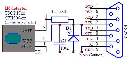

Hi, i am currently to a project which require me to do some electronic circuit. I have a simple infra remote control (Future Kit 410), to see the circuit visit, http://www.futurekit.com/basic_elec/FK410E-56.pdf .
I am suppose to connect the reciever with a USB port in order to connect to the computer. When the transmitter button is press, it have to send a signal to the computer tp trigger a VB program. I have no idea how i can connect the USB port to the reciever, neither i know how to send the signal to the computer. please help if you know. thanks.

Does anyone actually "READ" peoples post? Did you even bother to look at his attached pdf file to see his device? He has a premade IR TX/RX boards. The RX Module has a Relay contact output.
He wants to connect a relay output of an IR receiver board, the receiver board and transmitter probably has some decoding function already built into it., Whats there to decode?? His receiver will only give him a go no go setup with a relay, either contacts open or contacts closed.... unless he removes the IR receiver module from the board and decides to decipher the modulated signal then that would be different. But can still be done with RS232..... as long as he knows what info or data is in the modulated signal.

for the kit you show in your first post, there is no other way to get input from that board only through the relay contacts it provides....
Unless you want to remove the IR receiver from the board and use that, but the transmitter will still only give you 2 possible outputs since it was only designed to toggle the relays output on or off....
There is no way to connect that IR receiver to the USB directly, if you want to use usb to get an on/off signal from the relay, then that would be overkill for a PIC or AVR... If you are trying to use the remote for more than an on/off signal, I suggest you look for a more advanced kit than what you have to accomplish that.
My .02
P.S.
I attached a circuit to show how to connect the receiver from the kit you show to the serial port.... then get a Serial to USB adapter to connect it to a USB port if you must.....

so i should use RS232, serial port instead of usb port?
anyway, can u recommand me any software or program to test if the computer detect the signal? I will try using your the diagram u show me, but i not sure how to check if the computer can detect anything.
Should i use com port? or is there better software?
Actually i need to use the signal detect to trigger a progerm in VB(actually to send out a message), do you have any idea how can i do that?
Seriously thanks for your help =)

Ok, here is some sample code written in VB6, all you have to do is wire up an interface to the Serial port like I showed in the schematic.... then run the code, open up the right commport you have the device connected to.
when you receive a signal (relay closes) the red circle on the screen will turn green, when you lose the signal (relay opens) the shape will turn red.
I hope this helps......

Look if you really want to use USB, buy a Serial to USB converter and plug the circuit I already gave you to it, then you can connect the darn thing to a USB....
Plus, your receiver runs on 12 volts dc, the USB only runs on 5 volt around 500ma. If you connect that to your circuit it will most likely not work and possibly damage your USB port.
You really want to use a USB remote spend some money and buy a HTPC remote for your PC, then you can use that to run any application you want!!
