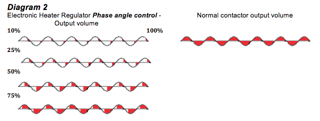

Then there is no reason (that I can see, given what I know) that you can't eliminate the variac and use a PID controller with a phase angle fired SCR straight into the primary.
Here's a sleek solution that could talk to a PLC
Here's a cheaper solution that would be used in conjunction with an inexpensive analog PID controller like this.
If you want to maintain your manual functions via the variac, you can still do that with a switch to select between variac control or PID control, but you will need to get a more advanced PID controller that has an Integral Hold input to avoid integral windup and over/undershoot when returning to PID control.

The step down pulls roughly 100A...can it handle that? I know PIDs usually turn ON/OFF things (pulse) to maintain a temperature. Can the pid be used to regulate the voltage going into stepdown?
strantor
Joined Oct 3, 2010
6,798
sure. If you get a PID controller with an analog output (i.e. 4-20mA), and a phase angle fired SCR with an analog input, it will control the voltage to the transformer by phase angle control. It works like this:
Instead of pulsing on/off every few seconds like the PID controllers you're probably used to, it controls the ON time during every single half-cycle of the AC waveform, thereby delivering consistent RMS voltage (although non-sinousidal) to the transformer without any interruption.

So the Phase angle fired SCR will be wired directly to line voltage replacing variac (control), the PID receives the temperature signal, lets say once PID decides a raise in temperature is needed, a signal is put out (4-20mA output signal) indicating ON in which I assume will be the ANALOG INPUT of the PAF SCR. How is this controlling (Raising/lowering) the voltage when its just putting out an ON/OFF signal? Meaning you somehow must pre-set your desired voltage = your desired output current? Can it handle up to 100A? Also, for initial start-up, the temperature is going to be close to ambient meaning the PAF SCR will start high at max voltage to try and get temperature quicker onto "load" (can limits be set lets say for "Max Voltage" = safety?...If not, I believe its unnecessary to stress equipment/wiring). Does the PAF SCR learn like the PID's autotune mode?
