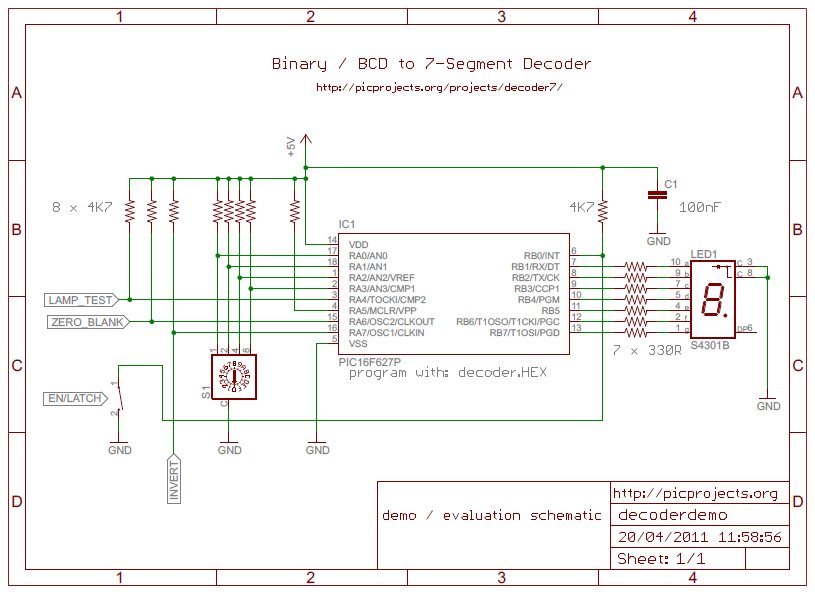

BUT, I have one more question, I got the codes here: http://picprojects.org.uk/projects/decoder7/
SOMETIMES the chip works! and soemtimes not. Just tell me if I need to make a new topic. :p
When I plug either regulated or unregulated power supply, at first it works for about 5 seconds, and then the circuit will turn off :(. Note that my supply is stable of course. I tried regulated 3.3volts, 5volts from arduino. and unregulated 3 to 6volts. I could see that the LEDs(or the segments of my 7segment display) blinks and fades sometimes until the circuit totally turns off.
glenn

Do you have current limiting resistors on the 7 segment display to keep the current under about 15mA per output?
The outputs are rated for 25mA, but there is a package limit as well, so if all outputs are putting out maximum current, you end up over the package limit.
Does the PIC get warm in the few seconds it is working?

Please post a schematic so we can see how this is all connected. A new thread for a new problem is a good idea.
edit to add: Is this your schematic?

hi sir 'thatoneguy' - you are right!!! When I remove the current limiting 100ohm resistor from the common cathode of my 7segment display, the display just blinks. When I put it back, it gives me a beautiful max intensity of the display. thanks!!!
My only problem is the LETTER c output. hehe. Anyway I can edit the data in the EEPROM.
thanks sir ErnieM. Yes that is my schematic. hehe. I mean, I use that one. how did you know? hehe. thanks to http://picprojects.org.uk. I am currently studying C programming for PIC, and I hope I can make my own bcd to hex 7 segment display program and simplify the connections of the pic chip.
