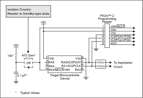

I know this is a bit off thread, but as I am designing a Nixie tube clock where a 40 pin PIC will be located under another board, I was thinking about in circuit programming it.
I've been writing PICs for 4 or 5 years and never done ICSP. Have you done this before?
I see from various threads that the MCRL line needs a little work done to it to enable the programmer to connect to it and also the 2 serial data lines need resistors in them too. I'm a little confused about the supply voltage though. I normally use my PicKit2 and recent addition PicKit3 to supply the voltage for programming. Could I simply connect the PicKit3 supply voltage pin to my common 5 volt rail on my circuit.
Luckily, I have not used the MCLR pin of the PIC in my project so I guess I can attach it directly to the programmer. The programming pins on the other hand connect to a 74141 BCD chip, so I assume I could put a resistor in series with the chip, maybe a 220R to 'isolate' the chip from the programmer.
Any advice would be great

Unless there is some rare constraint I *always* use ICSP, and will even use a larger pin count device (again if possible) to keep the MCLR, PGD and PGC lines free so I can also do in circuit debugging.
The rare exceptions are the times I used a PIC12HV615: just 8 pins, and the board was just so tiny I had no room for anything else. Board was literally about 0.1" by 0.3" and the leadless chip carrier PIC was pre-programmed before solder attach. Plus that chip doesn't have the debug circuitry.
Generally if the PGD and PGC are used as outputs you need do nothing extra to use as programming pins.
MCLR will be driven to a high voltage (up to 13V I believe) so it needs some isolation. Also put about a 10K pull up on it if doing in circuit debugging (which is no doable if PGD & PGC are used to drive other chips) so the circuit doesn't get flaky once you complete debugging.
PICkit 2 or 3 can supply power to the PIC, or use the power that is there. So yep, you connect the PICkit Vdd pin directly to the 5V rail. Same with the other 4 pins.

Hi again ErnieM, yes, in my circuit the PCG and the PGD pins of my PIC are both output pins, so are you saying I can simply connect these straight to the programmer without the need for resistors before the 74141 chip?
Also, if I'm not going to do in circuit debugging, does that mean the MCLR pin can be left completely free from the circuit and just connect to the programmer too, or is it still wise to add a 10k pull up resistor?
If I leave the MCLR pin with no connection to my circuit, will the 13V damage anything else connected to any of the other pins?
If this is the case, it should be pretty easy to add a 5 pin header to my already tightly populated board.
Edit:
I just found this image on the net:
What's the need for the capacitor?
